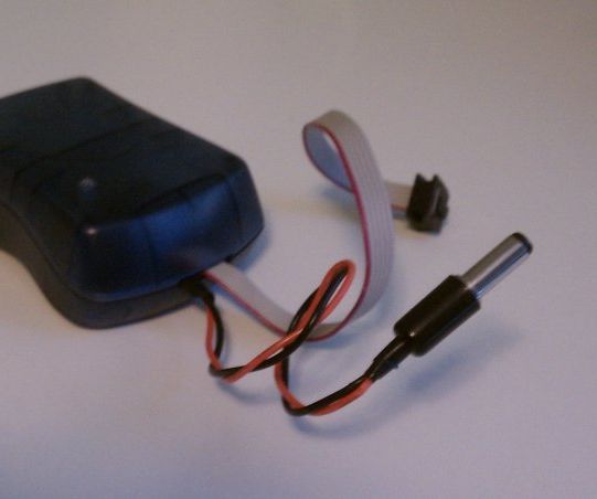

Go program something!!! Works well with your modded AVRISP mkII:
https://www.instructables.com/id/Add-Power-Supply-Plug-to-AVRISP-mkII/
