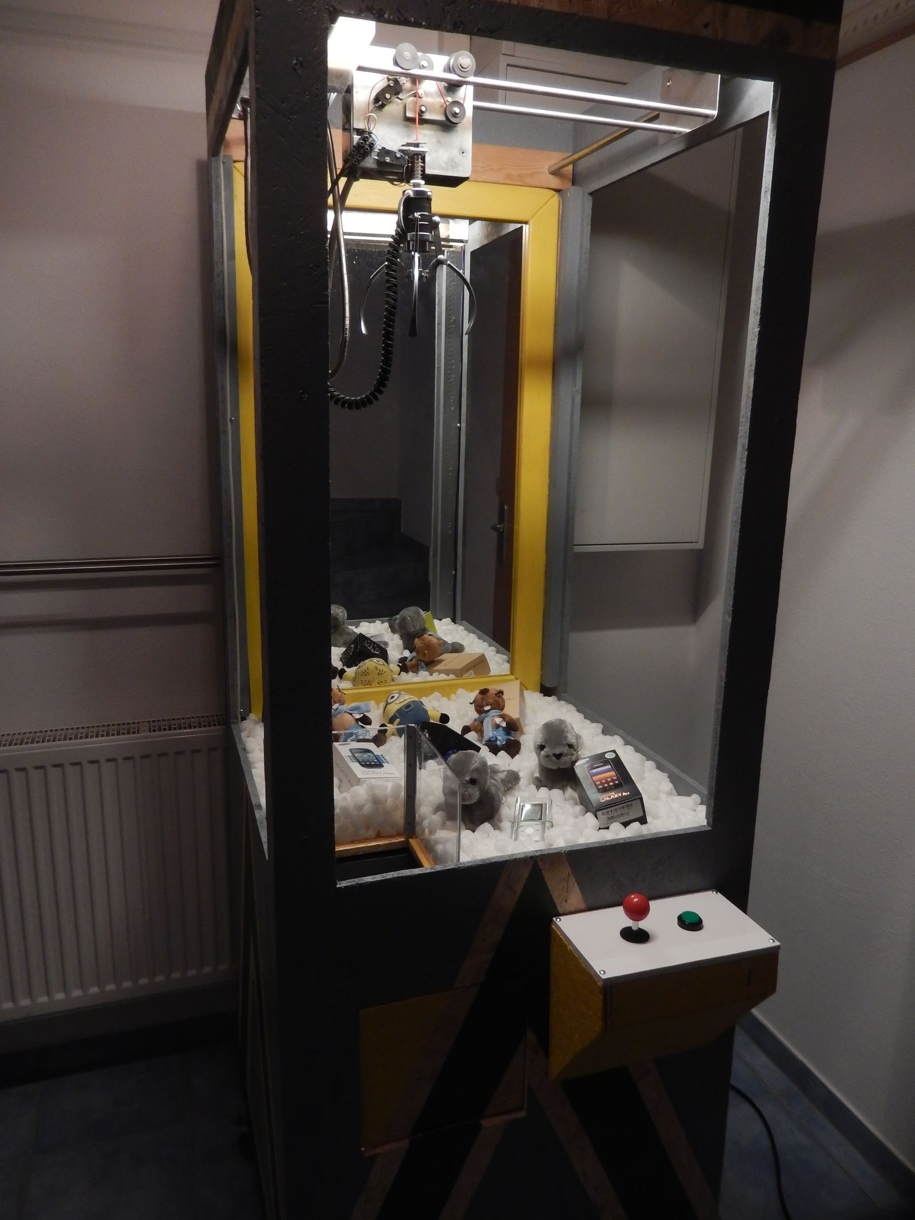

Here it is: The final version of my own homemade Claw Machine!
It workes with an arduino which controls the motors. Lots of people already tried out playing with the machine, it was a lot of fun for all of them!

In 2015, i started building a wooden cabinet for the claw machine.

Of course the machine needs some "Accessoires" like the Keypad and some LED lights.
Step 4: The Gantry Assembly
It is the most important part of the whole machine: The motors and the claw itself!

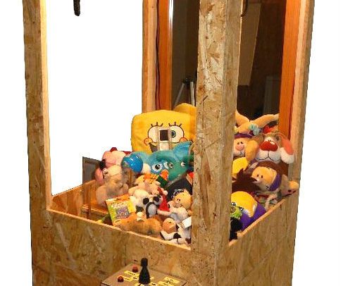

Step 5: The History of My Claw Machine
A few pictures of the very first version of 2015 until the latest and final version of 2018 of my awesome claw machine.
