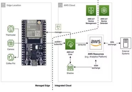

Introduction: AWS IoT Core | IoT Platform Series - 6 🚀
The AWS IoT is a cloud platform ☁ that provides services and solutions to connect and manage billions of devices. Since it is a part of Amazon Web Services, we can pipeline it with other products and services which will open more possibilities -
fig 1: Inter-Connectivity of AWS services
Collect, Store, and Analyze IoT data for industrial, consumer, commercial, and automotive devices 🚡 . To manage and support these IoT devices in the real-world, AWS IoT Core supports below protocols -
