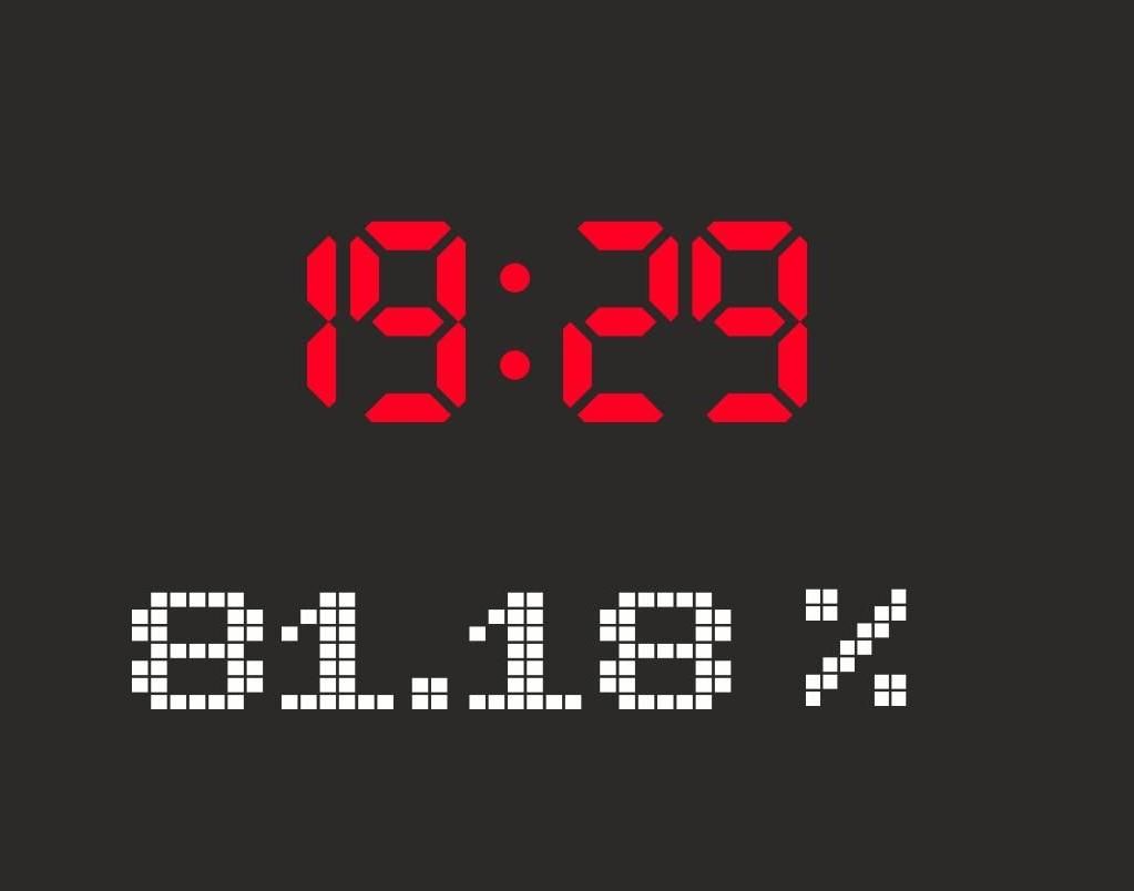

Step 8: Application in Practice
I made clocks with this encoder.
