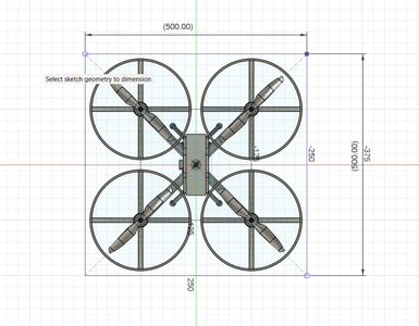

Step 1: Basic Functionality
Frame Design:
(e).1 forms an X-shape structure, with each rod hosting onemotor mounted by (f).2 and (f).3 as motor guards and ESC at its other end thats also mounted to the main

Step 4: Dimensions
Total Dimension : 470mmX470mmX200mm( guards included)
