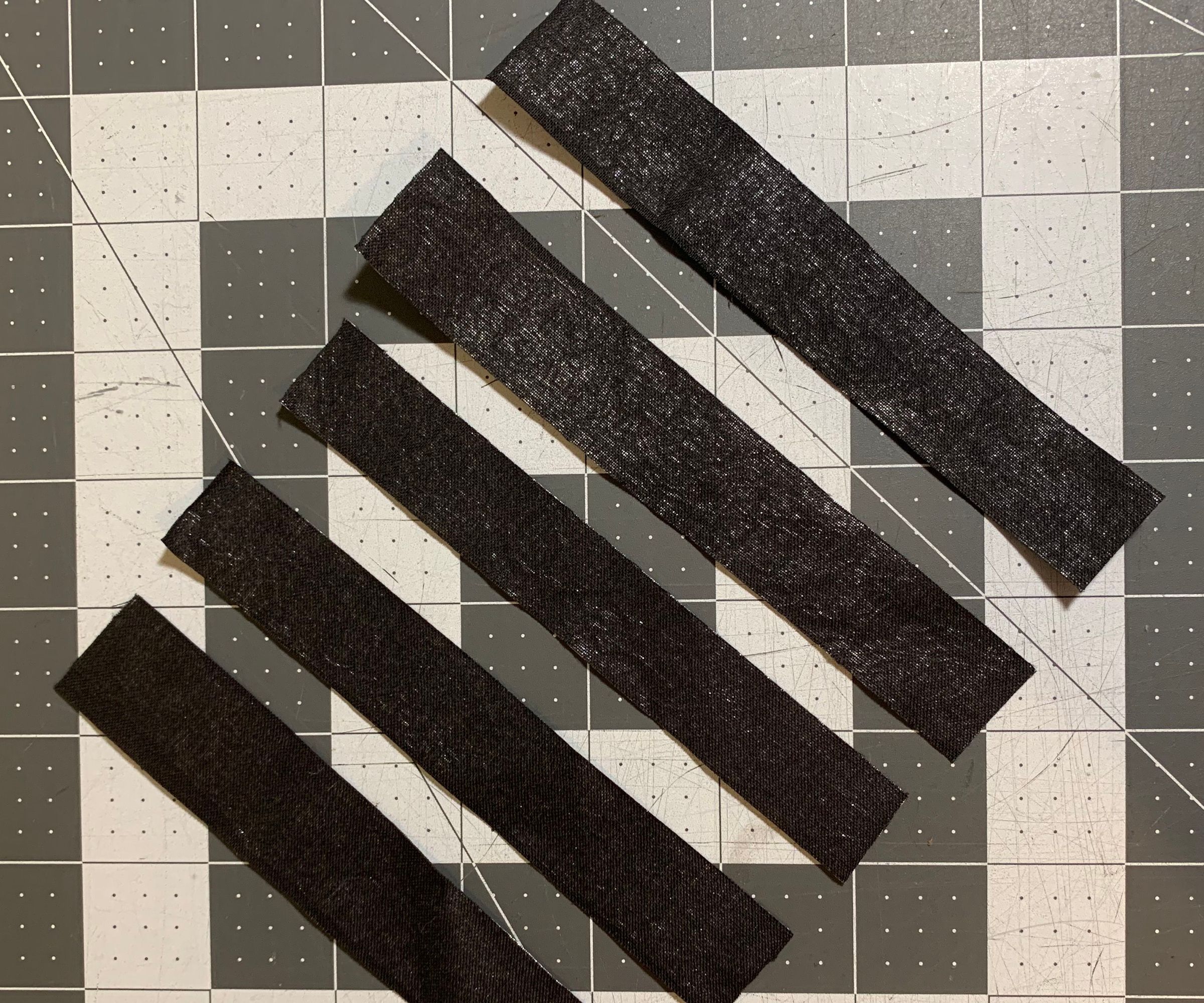

Step 3: Adding the Neopixels
Note when you are choosing your fabric you may need to adapt your techniques. This jacket is designed to demonstrate movement and direction and will be worn by a dancer, so it will be subject to extreme directional movement. Stretch fabric can be a problem when integrating technology into a garment especially when using conductive thread as it can make the connections unstable. To counteract this I used a strip of woven tape that is flexible but not stretchy, then applied this to the jacket.
Eight neopixels seems to be the max that can be effectively sequenced from the microprocessor with a 3.5V liPo battery. Conductive thread…is at the core of most of our wearble projects, but it does not carry much current — try combining multiple threads on the +ve and -ve terminals to decrease the resistance.
Sewing Tips:
When sewing ensure that your stitches around the terminals are tight, loose connections create problems, flickering lights or no connection at all. To thread the needle put a little clear nail polish on the conductive thread, it stops it fraying and helps harden the end so it fits more easily through the eye of the needle.
