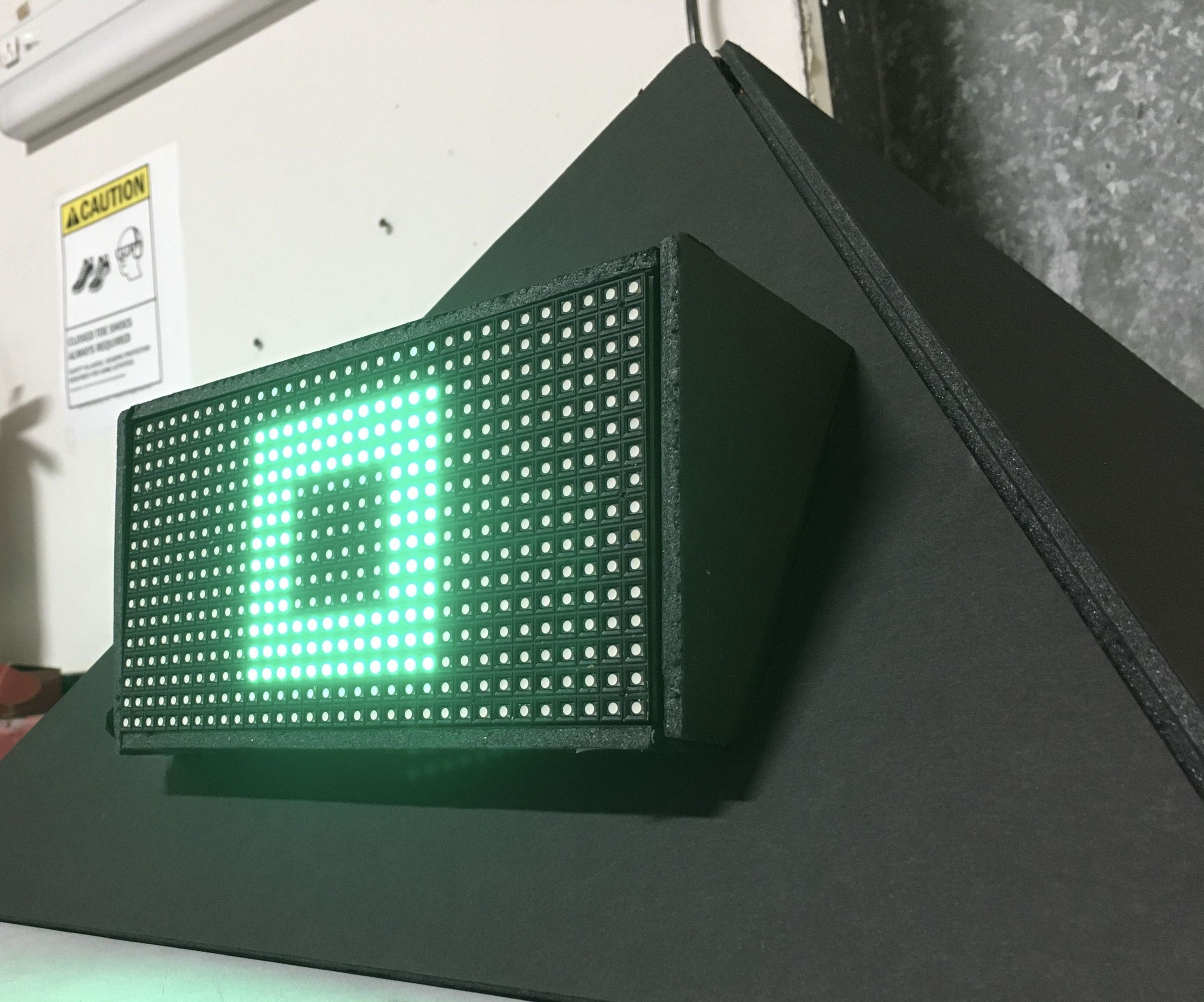

I had an idea for an electronic helmet that would make an excellent Halloween Costume. without going into too much detail it would involve lighting up in different patterns depending on which direction the mask turned, so that when I look up, the helmet lights up, but stays neutral if I don't move.

Congrats! if you got past the last step that means you are almost done. Now all you have to do is put all the parts in the box. [IMPORTANT] make sure everything stays plugged in accordingly, make sure the gyro is place front and center of the device or you will get improper readings, and make sure that nothing conductive is touching the front of the gyro, as it will short out the device and you will have to reset the Arduino. after that, you are pretty much good to go.
