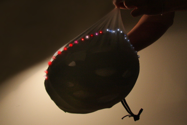

Introduction: Accelerometer-controlled LED Bike Helmet
If you cycle for fun, exercise, commuting, or compulsion, it's important to be well-lit and visible at night. Keeping the helmet lit is a good option because it gives your head extra protection. This helmet, the next in our Lumenhattio project series, has accelerometer-controlled turn signals--just tilt your head right when you're turning right on your bike, and tilt your head left when turning left.

Now connect the battery and try placing the hat on the helmet. Then try the helmet on!
Make any needed adjustments.
It might look bulky, but it's not heavy. For real!
Step 13: Prettify/Protect and Enjoy!
To protect the circuit and secure it even more to the hat and helmet, place a few hair nets (sometimes referred to as a snood) over the hat.
To protect the circuit from rain and add some light reflectivity, wrap the hat in strips of metallic contact paper. The hair nets will ensure that the contact paper doesn't stick to the circuit.
Your helmet is now ready to take for a spin!
