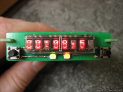

A logger unit for measure forces on a roller coaster and save them to a SD-card.
It's also possible to modify the software in the unit so it can measure other things if it can be connected to a i2c-bus.

I use a LIS3LV02DQ from ST-Microelectronics to measure the forces, a uALFAT from ghielectronics.com to manage the SD-card, a HCMS2915 display and a PIC16F876 to control every thing. I also use a Canon NB-4L battery ( the same model i have in one of my cameras) to power the unit.

Step 2: Prepare the PCB.
The PCB is in three parts and have to be separated before they can be populated with components.
(The new PCB layout has every thing cut out if it's ordered from a board-house and just needs to be broken apart.)
Step 3: Populate the PCB.
Start to populate the three PCBs. The 2 32KHz crystals has to be super glued to the PCB.
The trickiest part to solder was the sensor, that have all the connections on the bottom of the component (I borrowed the x-ray @ work to check that the soldering was perfect :) ).

Connect the battery and check that +3.3v_1, +3.3V_2 and +1.8V is correct.
Load the character map in to the external memory, then load a testing software to the uP to see if the unit is starting.
Prepare the sensor-board, it just need the sensor, some capacitors and a couple of wires.
Then connect the cable between the sensor and the main unit and check that the sensor is working.
The last thing to do is mount the uALFAT-chip and connect the SD-card.
Mount the PCB to Plexiglas with 4 screws.
Now you are ready to measure the forces in your car, bike and of course roller coasters. :)
