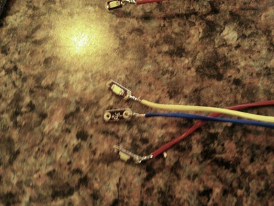

Step 3: Soldering Lights
Depending on the type of fabric you have, you may be able to use electrically conductive thread (available on SparkFun). I however, did not get that chance as I used an acetate taffeta fabric and actually ended up burning a hole in my skirt due to a short in my circuit. I therefore, decided to solder my lights to insulated wire to avoid further burnings.
Cut up a section of the ribbon cable, and split each wire and strip the ends. These are what we will solder to the lights and the accelerometer. I used colored wires as positive and grey as negative.
Make sure you know how to work a soldering iron, or ask someone to help you, as the lights are really small and it’s easy to burn a hole all the way through the light board
Once you’ve soldered the lights, check to make sure the solder worked. Use alligator clips and simply connect them to the positive and negative pins of the LilyPad.
Also, at this point, solder the larger section of the ribbon cable to the Lilypad Snap board. Each pin gets its own wire, make sure to solder a wire to the positive and negative pins as well, we will use them in a bit.

Step 4: Adding Lights to the Dress
Once again, because I used an acetate fabric, I simply had to burn small holes in the fabric for the LED wires to poke through to the underside. I also burned a slightly larger hole to allow the larger ribbon cable and the negative leads to reach the LilyPad board.
After you’ve got all of the LED’s situated onto your project, connect them back up to the larger ribbon cable. Be sure to solder them together and then cover it up with a bit of heat shrink tubing.
