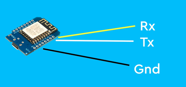

Step 3: Hardware
This is how I typically set it up: I connect Tx to Rx and Rx to Tx for the UART serial communication then I power it using the USB cable. Since I am using two different power sources, I need to connect ground from the Wemos d1 mini to the project's ground. As you can see the hardware is only a single Wemos d1 mini but any ESP8266 module or board can do the job. As long as your serial port is 3.3v then it should be plug and play. If you are working with a 5v serial then a logic shifter might be needed but from my experience so far, ESP8266 can handle 5v serial no issues.

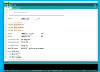

Step 4: Firmware
In the code, I created a web socket that sends any messages coming in from the serial port to the browser. Javascript code running on the client browser displays these messages in a text area. This was also used to get any commands sent using an input text field to the socket back to the wemos d1 mini which in return send them out over serial. I used a webserver on the ESP8266 to host the HTML, CSS and JS files.

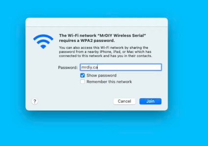

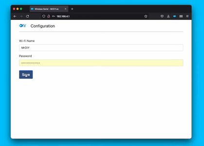

Step 5: Setting It Up
After flashing the firmware to the Wemos d1 mini, I went through the typical portal setup to enter my Wi-fi info. I made an earlier article about this topic. Then it is all set up.

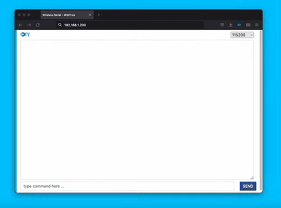

Step 6: Ready to Use

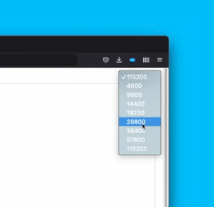

The serial port can then be accessed using a web browser and navigating to the IP address of the wemos d1 mini. This is what it looks like. If you have worked with any terminal before then the interface should be familiar. It has an auto scrolling window at the top for the console and a terminal prompt at the bottom. The baud rate can be changed at the top right corner to match the rate of the serial port. Each time this drop down menu is changed, a command is sent over the socket to change the serial speed on the ESP8266.
