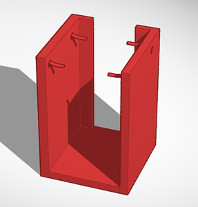

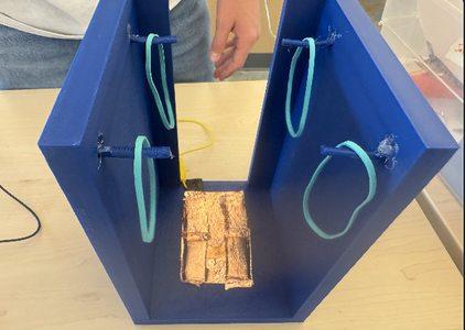

Step 1: 3D Print Stand
Download:

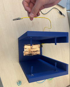

Step 2: Lay Tape and Foam Squares
Put copper tape on the bottom of the stand in a square shape. cut out and tape down 4 foam squares on the left and right sides with copper tape on top.

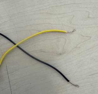

Step 3: Strip and Add Alligator Clip
Strip one side of the alligator clip and lay it on top of the tape, and then tape it down.

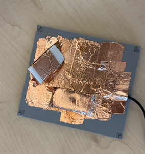

Step 5: Lay Copper Tape and Foam Square on Plate
Repeat step 2 on the plate
Step 6: Add Alligator Clips
Repeat step 3 on the plate

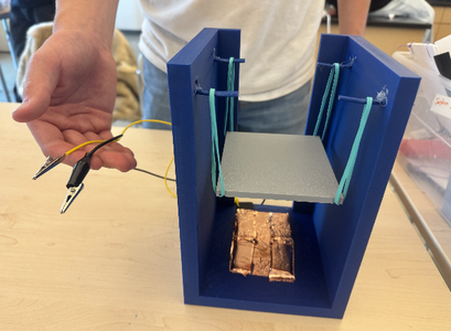

Step 7: Add Rubber Bands
Add the 4 rubber bands to the stand

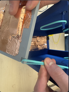

Step 8: Attache Plate to Stands With Rubber Bands
Clip the bands on the 3D printed plate, which has a place to clip rubber bands on the bottom
Step 9: Connect to Mackey-Mackey
Connect alligator clips to the up and down arrow on Makey-Makey. Then you're finished with the hand button.

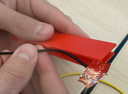

Step 11: Strip Alligator Clips
Pull off one side of an alligator clip do this for two.
Step 12: Tape and Attach
Tape the stripped alligator clips with copper tape to the top and bottom of the front of the mouth switch
