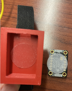

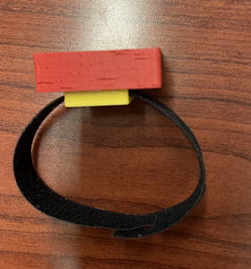

Accelerometer
  1. Add the small round velcro to the inner part of the red 3d print and to the LIS3Dh so that the accelerometer can be detached pretty easily, but doesn't move when we move the parts and give us accurate readings
  2. Attach the yellow 3d print to the bottom of the red facing the same direction of the red 3d printout
  3. Slide in the hook and loop velcro
