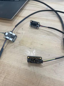

Make absolutely sure that the small orange piece of tape covering the sensor on the VL53L1X ToF distance sensors is removed before the project, as with the tape on your readings will be inaccurate.

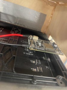

Plug the Matrixportal into the HUB75-D slot, and connect one I2C cable into the I2C port. With the other end of the cable, plug into the PCA9546A in the side port. Next, take one VL53L1X and connect it to port 0 and another on port 3.
Lastly, be sure that the power cable included with the LED matrix is connected to the matrixportal with the red cable connecting to 5V and black to GND.

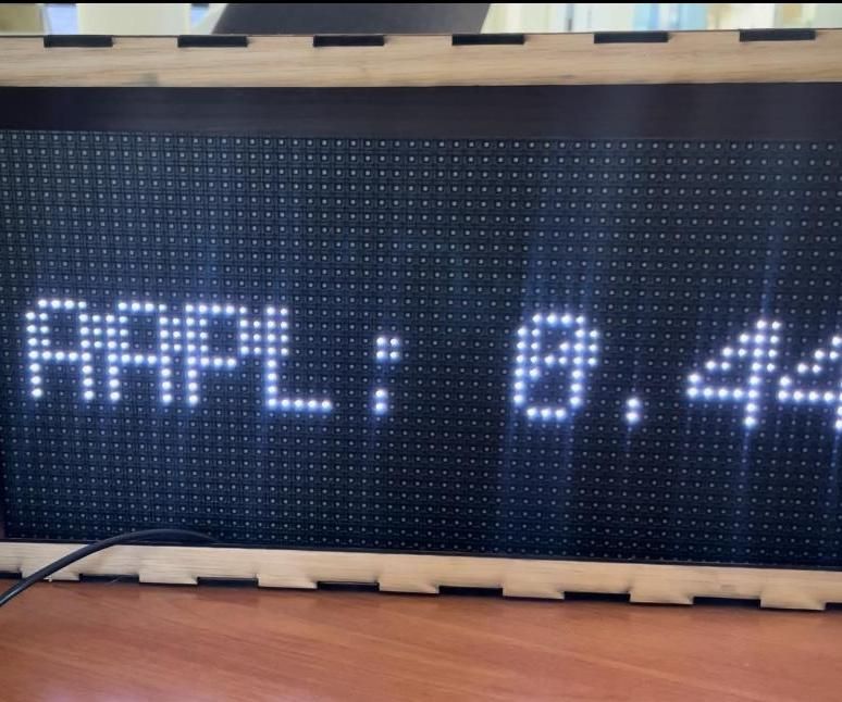

With CircuitPython on your board and the adafruit-circuitpython-bundle downloaded, copy the attached code to your code.py file. In the code you will not only find an easter egg containing my favorite and least favorite baseball teams, but there will also be code for setting up the display, interacting with the multiplexer and connected time of flight sensors, ball and paddle sizes, ball and paddle movement, also containing score displays and a win screen.
As for a note regarding the sizes of the ball, text, and speed of the game. I decided to make the ball larger and game slower than usual to make it more accesible to the students at the Campus School. The same goes for the text being large as it makes the score easier to read.
