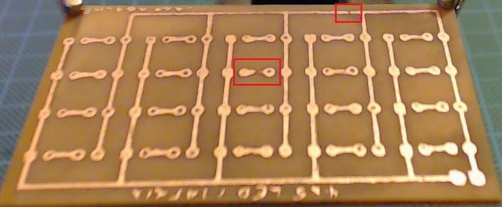

When your board is properly etched it will be a bit transparent. You can test the etchedness of your board by taking it out of the bath and giving it a thorough rinse and dry and then hold it up to the light. You should see your copper traces clearly through the board. If this is OK, then get out your multimeter and switch to continuity test. Test the board by placing the anode (or cathode, it doesn’t matter which) on a trace and the other one (cathode or anode) onto the field of the PCB … where there isn’t supposed to be any copper. If you get a beep, then it’s back to the bath. You might also want to do a regular continuity test from one end of each trace to the other to make sure that your traces are, well, continuous.
You will still end up with gaps, sometimes, the way to fix this is to make a solder bridge over the breaks.

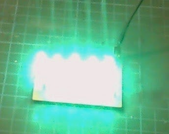

The image above is of a 4 x 5 LED matrix that I made (a cheap desk lamp). There are two spots on the board (with red borders) that are such gaps in the trace. For these, I made a solder bridge by building up a fillet of solder at both ends of the break and then dragging the soldering iron across the gap, the solder followed the iron and a bridge was formed. If you have gaps that a solder bridge wont fix, solder in a small amount of copper core wire. Go over the entire board with a multimeter on continuity test to make sure all of the traces are complete. Sometimes, the gap is microscopic and this is the only way to find your faults.
