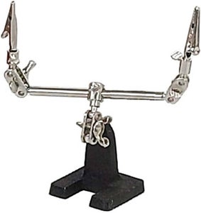

Helper Hands to construct a simple transmission measurement setup

Fix the xenon lamp onto one of the crocodiles of the helper hands. Connect the lamp to an Arduino Uno 3.3V output (GND and 3.3V using two separate wires). Hold the fiber of the spectrometer with the other crocodile of the helping hands. Align the fiber so it looks at the light source, about 1 cm above the surface of the table.

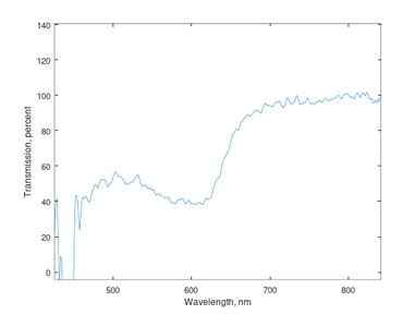

First, pour red cabbage juice into the cuvette. Place the cuvette close to the fiber optic cable light input. Observe the transmission in the spectrometer software. There is a broad absorption line around green (~ 565 nm).

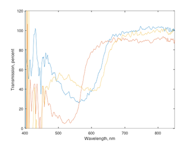

Add a few drops of white vinegar into the cuvette. Observe transmission spectrum. It is seen that the absorption (the dip in the transmission curve) shifts towards UV wavelengths. The cuvette now turns orange/red because blue is absorbed due to acidic pH.

Use a Q-tip to transfer a small drop of bleach. Mix with a toothpick or a clean Q-tip. The color shifts towards greenish hue. Observe the transmission using the spectrometer software. The absorption has shifted red towards 600 nm.

When we compare the transmission spectra, it is seen that vinegar (acidic) shifts the absorption peak towards Blue/UV, and Bleach (basic) shifts the peak towards Red. The peak position can be correlated with pH level.
