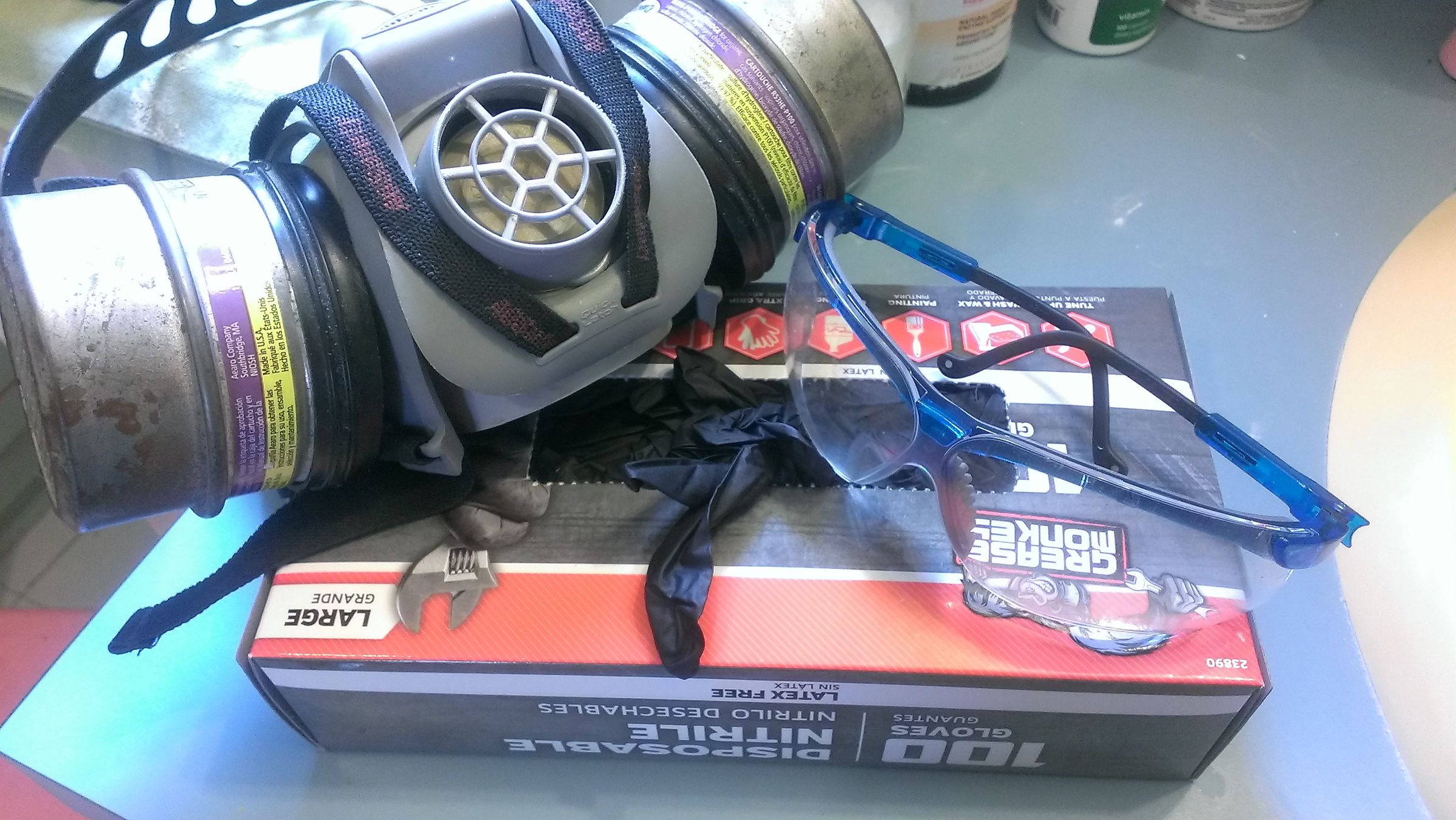

Step 1: Safety Notes!
DISCLAIMERS: Don't do this kind of stuff at home if you don't have a basic understanding of high school chemistry. You will hurt yourself BADLY, and I won't be held responsible. Legalese out of the way; onward!
Safety first, you are working with dangerous chemicals.
1. Goggles, eye protection: wear them.
2. Gloves: get some. No vinyl, acetone will melt it. Nitrile is good, rubber is better.
3. Respirator if you have one, the fumes from this procedure can be quite irritating. You may want to complete this outside if you do not have a well ventilated room. Do not purposely inhale the fumes. Don't quote me, but I have read the fumes may contain chlorine gas amongst other things, and chlorine will kill you in high enough doses. Be smart.
4. All bowls, containers, measuring tools, and funnels must be glass or plastic. Metal will corrode!
Another IMPORTANT note, this will void any warranty you have. I'm not responsible if you attempt this and dissolve your blade. Pay very close attention to the timing of your acid bath, and don't etch screws. The acid will eat the threads, and then you're the one who's screwed.
