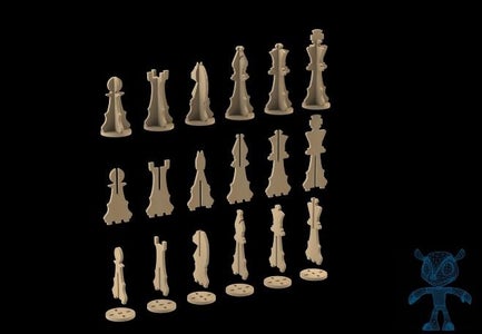

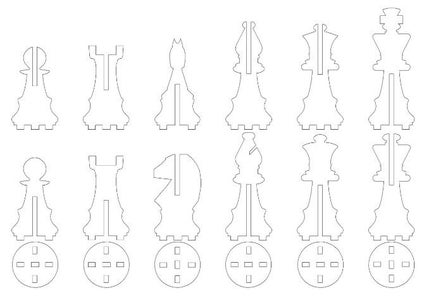

Initially, the idea was to make shapes from 2 parts (round base and a shape inserted into the base). But it's good that I thought of going on the Internet and looking for ready-made models for cutting there. On one of the sites I found a layout that was different from my idea, but, in my opinion, it was even better.
https://rezkalaser.ru/chpu/3d-model-shahmatnye-figury/
Step 3:
As always, I threw everything into CoralDraw, made the required number of copies of each figure. Then I placed them as compactly as possible. The file is ready for cutting. But I will cut this acrylic for the first time, so it is necessary to determine the mode.
Greetings from the future: As a result, parts of the figures were easily disassembled. I recommend reducing everything by 20%. Probably this is due to the fact that the thickness of the acrylic is not exactly 2 mm

Next, I cut out 17 more shapes for the opposing team. And for the sake of distinction, I just painted them with matte black paint.
