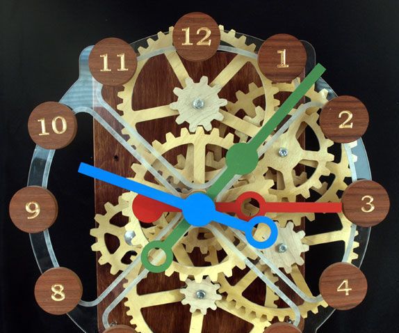

Introduction: Acrylic Gear Clock
The clock by DickB1 was the inspiration for my design of a similar mechanism, however, with the gears made from Acrylic.
The driving force for the pendulum is an electromagnet similar to the one used by DickB1. However, the magnet is attached to the very end of the pendulum where the driving coil is mounted directly underneath. This applies the electromagnetic force inline with the pendulum swing plane. I saw several magnet-coil arrangements elsewhere.
The coil is energized by means of a simple Arduino sketch. A high-precision crystal clock (ChronoDot) is used for time keeping. A small OLED display shows the date and time from the RTC.
A number of push buttons on the control box can be used to adjust the RTC clock when it eventually drifts off, supposedly at a rate of less than a minute per year.
The mechanical clock has no direct correlation with the electronic clock except that it is advanced once a second. To align the hands, one has to do it manually. The minute hand can be turned by hand by means of a one-way clutch. Finally, the second hand can be stopped temporarily by by inhibiting the pendulum from swinging.
The design steps are organized starting with the basis mounting board that is indented to hang on a wall with a keyhole hanger. Next, we look at the pendulum and the driving coil.
Then we design the back plane that holds all shafts and the cowls for the escapement.
Lots of gears are cascaded on the shafts ending up driving three concentric shafts for the second, minute and hour.
Finally, the front face finishes the gear assembly. The last step is attaching the hands to the concentric center shafts.
All parts were designed with CorelDraw XIII. Most parts were machined with a CNC router. VCarve Pro was used to convert DXF files from CorelDraw into toolpaths. A mini lathe came in handy to machine aluminum shaft hubs and spacers.

Step 14: Finished
This the result when fully assembled. Everything of the gear train is visible due to the clear Acrylic. I did apply some color to the tips of the hands so their position can be made out more easily.
