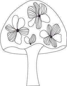

Step 2: Trace
I used my uploaded image to start tracing my design starting with the shape of the design, a mushroom.
Step 3: Trace
I continued tracing the details from my image using the pen tool and shape tool to create the flowers.
Step 4: Detailing
I added more detail to my flowers be using the pen tool to create lines for variation.

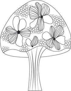

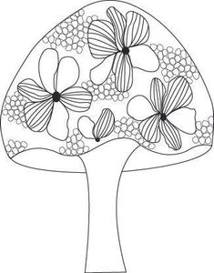

Step 5: Trace
I also added clusters of shapes to fill in the white space in my design using the pen tool as well.
Step 6: Detailing
Next, I added texture details to the stem of the mushroom using the pen tool.
Step 7: Detailing
I also used the shape and shapebuilder tools to create a base of grass for the mushroom to fill up more of the empty space and imperfections on the bottom of the mushroom.

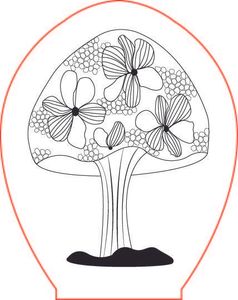

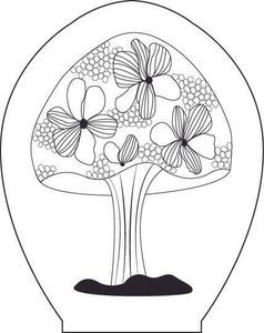

Step 8: Outer
Lastly for illustrator, I used the shape and shape builder tools to create the outer shape for the acrylic when it gets cut. I measured the rectangle at the bottom as well to fit into the light base.
Step 9: Print Ready
To make my design print ready I had to make all of my elements into paths so that the machine could engrave/cut them. I also color coded the engraving elements to be black and the cutting elements to red.
Step 10: Print
Finally, we printed my design onto the clear acrylic, creating the surface that the light would shine through. I assembled the light by inserting the acrylic into the nook in the light base and it was done! I turned the light on and watched my design light up in the color of the led light.
