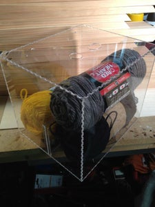

An acrylic yarn box like this one not only stores your yarns but also acts a way to dispense the yarn as you're working on new projects. Clear acrylic is a great material for being able to see what yarns are stored in each box and how much yarn you have left without even opening your yarn box.

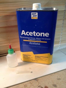

  2. Acetone - smallest size container you can find
  3. Small funnel
  4. Acetone needle bottle / applicator (can get online, just google "needle applicator")

My box dimensions for this Instructable are 8.5" x 8.5" x 10".  I chose these dimensions based on some common sizes of yarn balls.  I wanted to take the longest and thickest sizes and be able to hold 4 full balls.

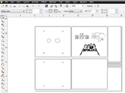

Step 4: Import and Add Extra Design Features to Your Box Design
Open CorelDraw and import the PDF file you just downloaded.  You will need to move the objects around so that the pieces fit the size the acrylic you will be cutting.  Not all of my pieces fit onto the 24" x 18" piece of acrylic, so some of these pieces will be put into a separate, 2nd file or as 2 pages as CorelDraw can also do it.
Now that we have our overall geometry placed, it's time to add some extra features. A couple of "must have" features to add to your yarn box are some holes on one or many sides to allow yarn to feed through them, and holes for the lid. I recommend putting the yarn feed holes near the top of the box so that there's less chance the yarn gets tangled. The top of the box will be snug when fully closed, so it's a good idea to put in 2 finger holes on the lid piece so the lid can be easily removed.
Other features you can include: Holes or handle features, engrave in custom decorations, whatever you like.  One extra feature I'm adding is a removable divider that's just under 4" x 10" in size.  I also design in the acrylic guide pieces that hold the removable divider in place.
I've included a copy of my CorelDraw CDR file if you want to see how everything is setup in greater detail.  Note that the file has 2 pages!

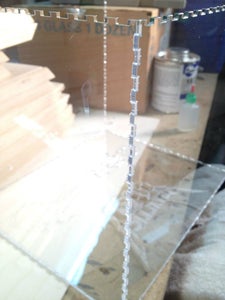

Step 6: Dry Fit Your Parts Together and Clamp Lightly (optional)
Remove your pieces from the laser engraver and dry fit them together. The pieces should fit rather snug if the kerf value you used was accurate. To ensure the parts stay snug while we are solvent welding you can clamp them together. A light clamping is all that's needed, too much force and we will crack our acrylic.
A word of advice, do not use rubber bands or anything like that long any edge you will be solvent welding. What will happen if you do that is the acetone will find its way to your rubber bands and run along the flat surface area of the box instead of just in the joint areas. When you remove the rubber bands a permanent mark will remain on your flat surfaces and it won't look so good. Learn from my mistake!
To solvent weld place some acetone into a special applicator used for such things. These can be purchased from several places online like eBay, hobby shops, Grainger, etc.  Just Google "needle applicator".
For my example, I did not clamp the pieces but I did tilt the box as I applied the acetone to ensure the acetone stayed in the joint area.  Another word of advice, I recommend only filling the needle applicator about 1/4 full or less.  As you tilt the bottle beyond horizontal, the acetone will want to drip out.  Try to avoid getting acetone drips on the non-joint areas of the acrylic.  If you do, do NOT try to wipe it away.  Let the acetone drip dry on its own, give it at least 5-10 minutes.  Then you can try to wipe away with a cloth.
