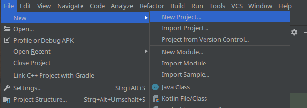

  1. Open Android Studio and create a new project with File -> New -> New Project

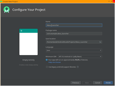

  3. Select Language "Java" and input reasonable data, for example
    • Name: Alexa_Launcher
    • API 16: Android 4.1 (Jelly Bean)
  4. Confirm with Finish

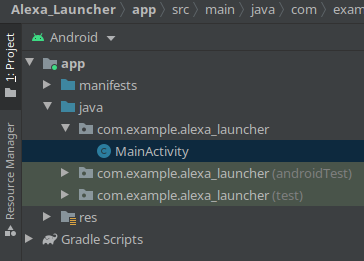

  6. In the Project explorer on the left select app -> java -> com.example.alexa_launcher (or your name from before) -> MainActivity
