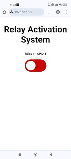

The electronic board system consists of a relay to activate the load. To do this, there are 2 ways to activate the relays: you can use a button connected directly to the board or use a webserver with buttons to activate it.
In this application we use a server to allow activation through a web page. See the interface below.
The interface presented above is not my own. It was modified based on Rui Santos' code. All credits and link to the author's page are at the end of the article. Below we have the modified code.

The purpose of the code above is to switch the relay state by pressing the button on the web page. The code above allows you to insert several buttons to control numerous relays. To do this you need to change the number of relays, which can be configured in the line of code below.
#define NUM_RELAYS  1
The relay control pin was configured for GPIO 4, which is defined in programming through the line of code below.
int relayGPIOs[NUM_RELAYS] = {5};
Using these configurations, activation tests were carried out with a lamp supplied from the mains with a voltage of 220V.
