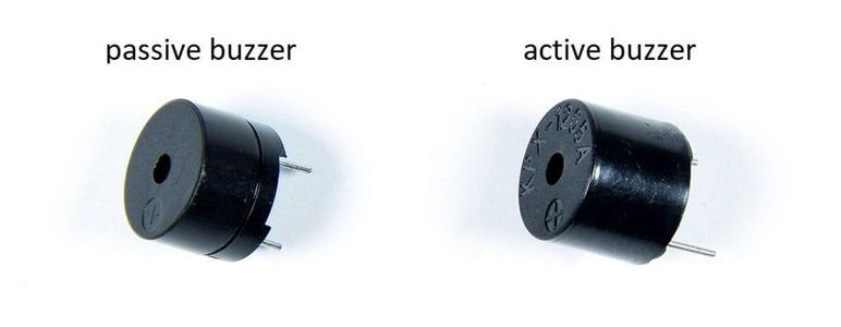

There are two types of piezoelectric buzzers available in market which are categorized as passive buzzers and active buzzers. In this article, we will see the main difference between two and how to use them in your project. Buzzers are not used only for notifications but also, they can produce different tones. We will pair these buzzers with Arduino and write a minimal program for them. Build your own Arduino microcontroller using PCBWAY prototype service. Sign-up now and get new user coupons to order first PCB prototype.
Step 2: Active and Passive Buzzers:

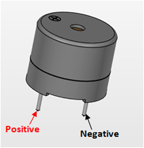

Active buzzers are called active because they can produce sound directly when connected with the battery. Active buzzers can produce a single tone which is tuned to 2khz by most of the manufacturers. On the other hand, Passive buzzers need a triggered wave to produce sound. So, these passive buzzers can produce a number of different tones based on the input frequency of signal. All type of buzzers is polarized, positive and negative terminal is mentioned on them. Connect positive to the positive of battery and negative to negative.
These buzzers can’t be distinguishable only be looking. Connect them to battery keeping polarity in mind, active buzzer produces a loud tone and passive buzzer just produce a pop sound.
