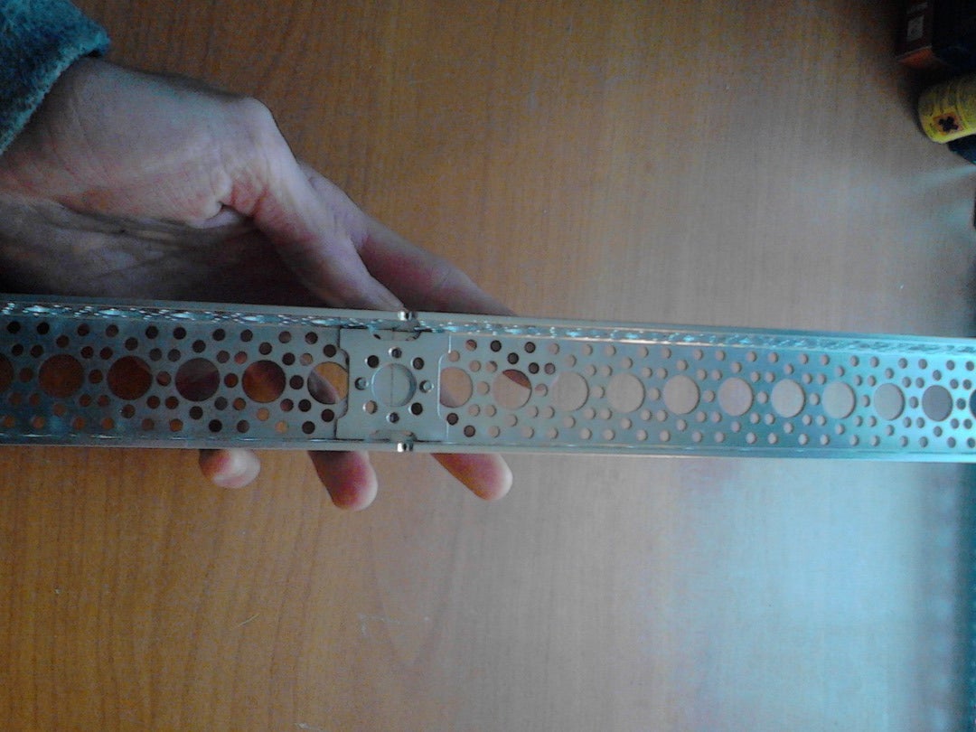

Step 2: Build the Main Body
So we must now start building our stand.
Take the 9" and 6" channeland connect them with a quad hub mount D and 2 socket head machine screws. One screw in each channel. The hub mount should be inside the channels.Then from the outside of the channels connect the second hub mount D with 2 flat head screws.
Thats it. Now we have two15" channels which they are the main body of our stand.
