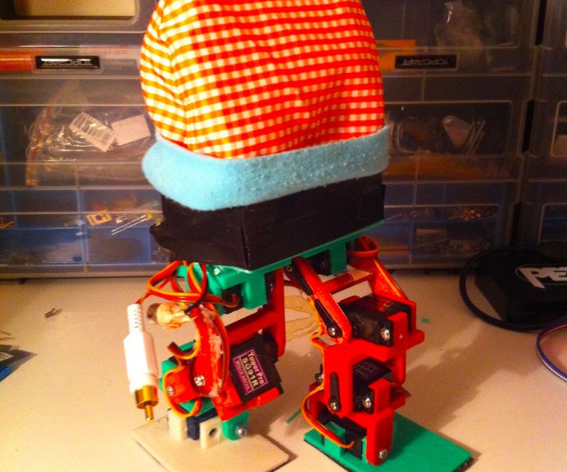

This robot has curved feet and a free hip. 4 servos are controling the Mediolateral and the sagittal positions of the ankles. A MPU 6050 is used to drive the Medio Lateral servos at the correct time to achieve the balancing mouvement on level ground. By driving the position of the Antero Posterior servos, we can modifie the position of the center of mass of the robot. When it pass in front of the center of curvature of the feet, the robot begin to walk.

The printed parts were inspired from the one of cevinius http://www.thingiverse.com/thing:170932. I just resized it to have enough space in the leg to add the servos. These servos are controlling the ankle in the frontal plane and in the sagittal plane. The ankle has 2 degrees of freedom done with a gimbal joint, the first axis of this joint is printed, and the second one is a M2 screw. The servos control these DOF using links with rod end balls (APLink and MLLink, see notes on pictures).
The hip is free, the leg must turn around his axis freely inside the body to allow +/-10° of flexion extension. When it’s done, add the hip stop to maintain the leg in his place.
You may have to “re-drill” the holes, and taping the holes were you have to srcew something.

After few hours of testing, my robot was able to walk!
