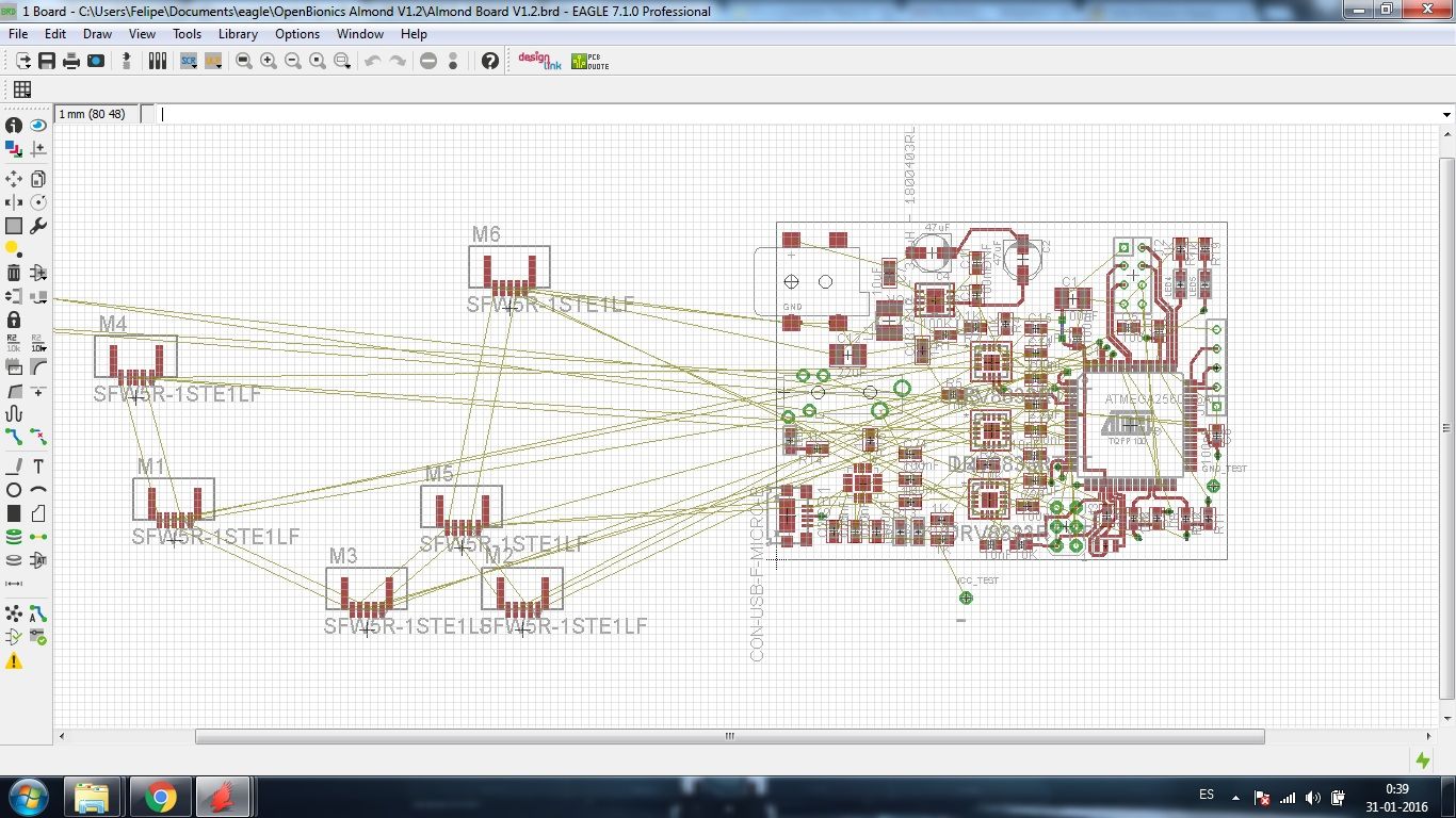

Step 4: Mounting the Electronics
With the PCB tray mounted, we need to connect the Almond board to the hand.
You will need:
- Palm assembly with motors and PCB tray
- Almond board
Note, the steps differ slightly between a left and right hand.
Both hands
- Place the Almond board upside down on the back of the fingers
- Unclip all of the motor connectors by using tweezers to gently slide the black clip away from the motor connector
- Plug in all of the finger motors by sliding them into the connectors, orientated so that the copper pads are facing into the board
- Slide the black connector clips back in to lock the motor cables into the connectors
Right hand only
5. Plug the thumb motor cable into the top RIGHT motor connector and lock the connector
Left hand only
5. Plug the thumb motor cable into the top LEFT motor connector and lock the connector
Both hands
6. With all of the motor cables connected to the Almond board, place it so that it just slots onto the top of the PCB tray, depending on the material you have used, this may be either a tight or a loose fit.
The motors and electronics are now mounted and the hand is ready for the back cover.

can you share the board in ".brd" to eagle software?. Thanks
Reply 7 years ago
Hi FelipeG8,
All of the Almond files and documentation can be downloaded from www.openbionics.com/downloads
Reply 7 years ago
Ok, thanks. Now, i will try to make the PCB
