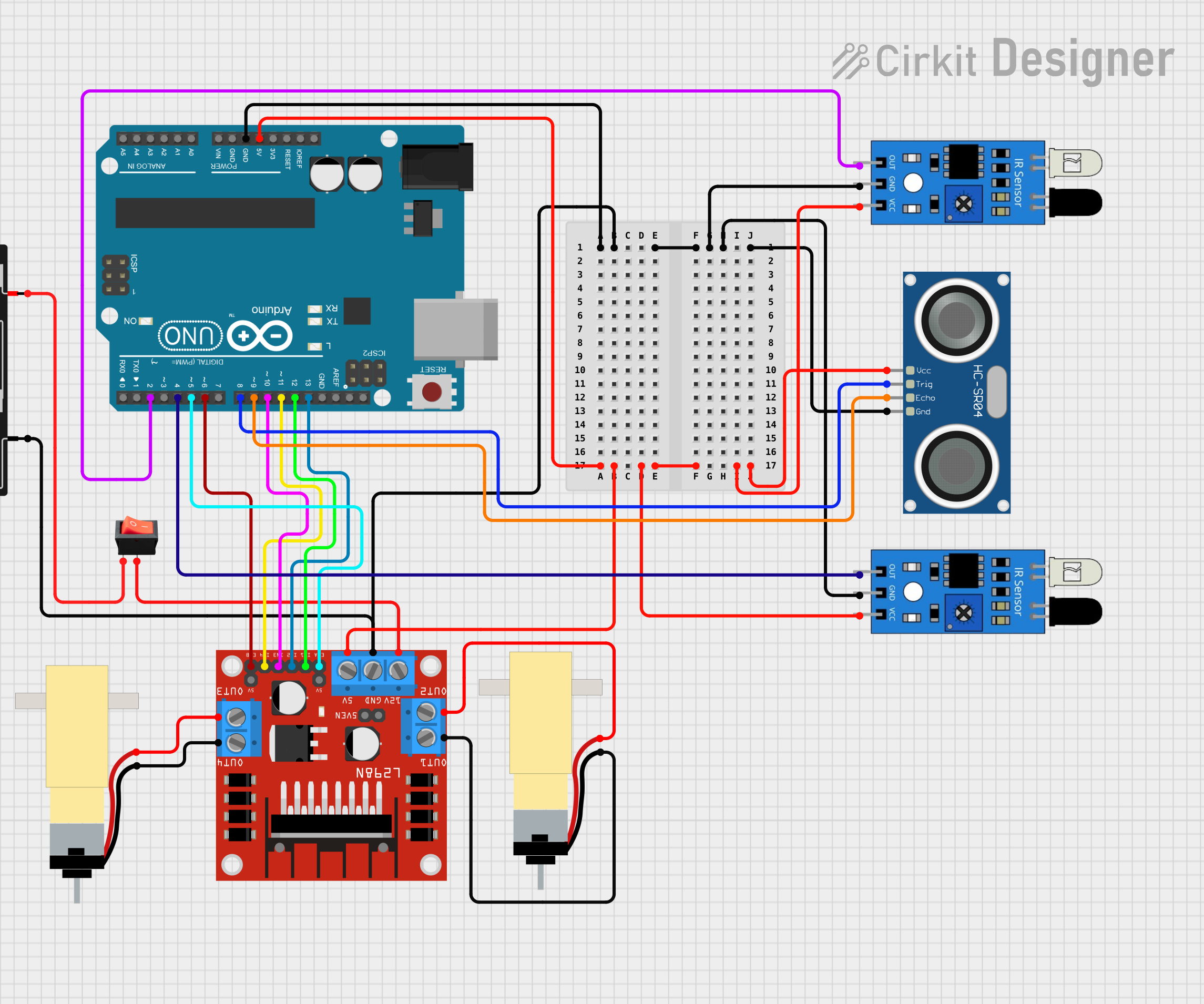

Step 3: Wiring
We can see how to connect the Arduino to the BME680 in the circuit diagram generated with Cirkit Designer, which is a great tool for circuit design and diagramming.
BME680 <---> Arduino Uno
  • Vin <---> 5V
  • GND <---> GND
  • SCK <---> A5
  • SDI <---> A4
Also make sure to connect your Arduino UNO to your computer via USB.
