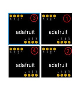

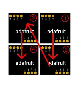

Step 1: Arrange Dotstar Matrices and Solder
Once you have your 4 Adafruit Dotstar Matrices in hand you can go ahead and arrange them. It is very important that you follow along the pictured diagrams provided in this tutorial. Once they are all aligned and in order you can go ahead a super glue them together to avoid gaps between the matrices.
tip: I would test them first with the code and later glue them together.
Once everything is lined up you can begin to solder the Dotstar Matrices. For best results, please follow the diagram provided.

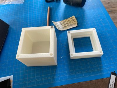

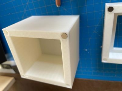

Step 4: 3D Print Box
For this project, I created a 4x4 3D printed box to house all of the electronics. You don't need to have it 3D printed, but you can use the STL files provided to print your own.

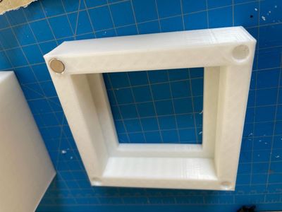

Step 5: Place Magnets, Acrylic Screen and Matrices
If you used the STL files provided, you might have noticed that there are 8 slots around the corners of both parts printed. These are meant for the neodymium magnets. These magnets are going to provide us with easy in and out of the box in order to arrange the electronics inside. you might need to sand or drill a little bit for the magnets to easily go in.
After doing this, you can go ahead and super glue a piece of semi translucent acrylic from the inside of the lid. Once that's done, you can glue the matrices to the acrylic piece by using hot glue. Make sure to put the glue around the frame of the matrices and not on top of the LEDs. Make sure that the matrices sit flush against the acrylic.

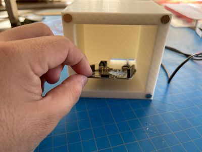

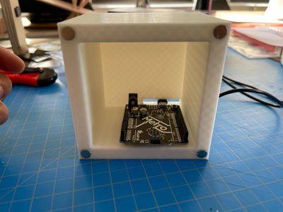

Step 6: Place Arduino Board Inside of Box
to place the arduino board to the box you first need to align the power port to the hole in the back of the box. This hole is for the power cable to slip through once everything is put together. Put hot glue at the bottom of the Arduino board and glue it inside.
Step 7: Final Step
After placing the arduino board you're ready to connect the matrices to the arduino board (use diagram provided earlier) and snap the two pieces of the box together.
