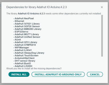

Step 1: Install Arduino Libraries
To install the right libraries, open your Arduino IDE and go to the library manager. Search for this library: Adafruit IO Arduino, and click on Install. It might tell you that you have some missing dependencies for this library, you can click Install All to install everything you need.
