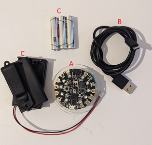

  • A - Adafruit playground express X 3 - Here
  • B - Micro USB cable X 1 - Can be found in your local convenience store
  • C - 3 X AAA batteries X 9 - Can be found in your local convenience store
  • D - 3 X AAA battery holder X 3 - Here
  • ESP 8266 Wifi board for the arduino X 3 - Here

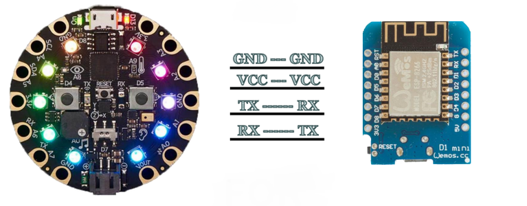

Step 2: Solder the ESP8266 Board to Your Arduino
First you will have to solder the ESP8266 board to your arduino.
To do so, use the electrical wires that comes with the kit of the solder, and solder the Arduino to the ESP8266.
As the picture shows, you need to connect the GRN on the Arduino to the GRN place on the ESP8266.
Do the same for all the wiring instructions in this photo.

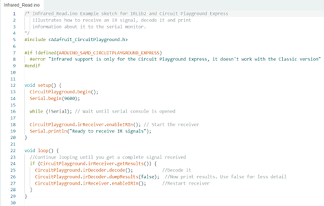

1.First, in order to discover and decode the specific protocols and code of our devices (TV and AC), we have used the Infrared_Read.ino Example sketch for IRLib2 and Circuit Playground Express.
As you can see, while running this program and pressing the buttons on our remote controller , we can see the data that is printed on the serial monitor (picture 2)
2.Define the Values: (check picture 3)
3.In order to use the IR signals of our devices (TV and AC) as follows:
CircuitPlayground.irSend.send(MY_PROTOCOL,MY_TV_POWER,MY_BITS);

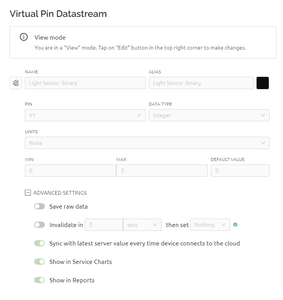

Step 5: Setup Blynk
This project is using the power of these two application -
1.Blynk
2.Integromat
First create a user for Blynk, just go to their websites and follow the create new account instructions.
The Blynk side -

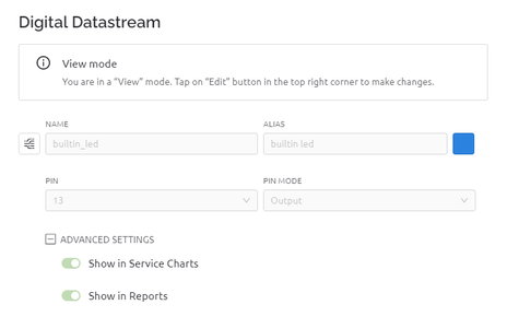

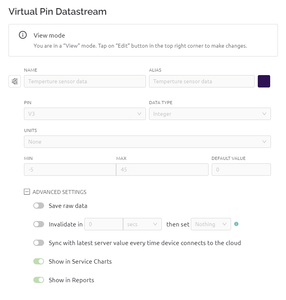

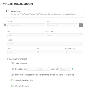

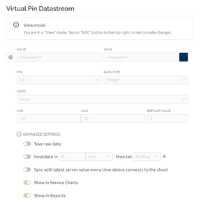

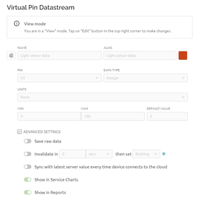

  1. Create a template for your application - you will use it to create your Blynk application.
  2. Follow the attached photos and configure the pins as shown.
  3. Your Blynk app should have a token that we will use later, you can find it on the main page of your application, save if for later, we will need it.
  4. Create a dashboard with the relevant pins as shown in the dashboard picture.

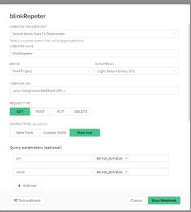

  5. To create the webhook go to Blynk settings, and open the Webhooks section from the side menu.
  6. add a new Webhook with the configuration from the last image.
