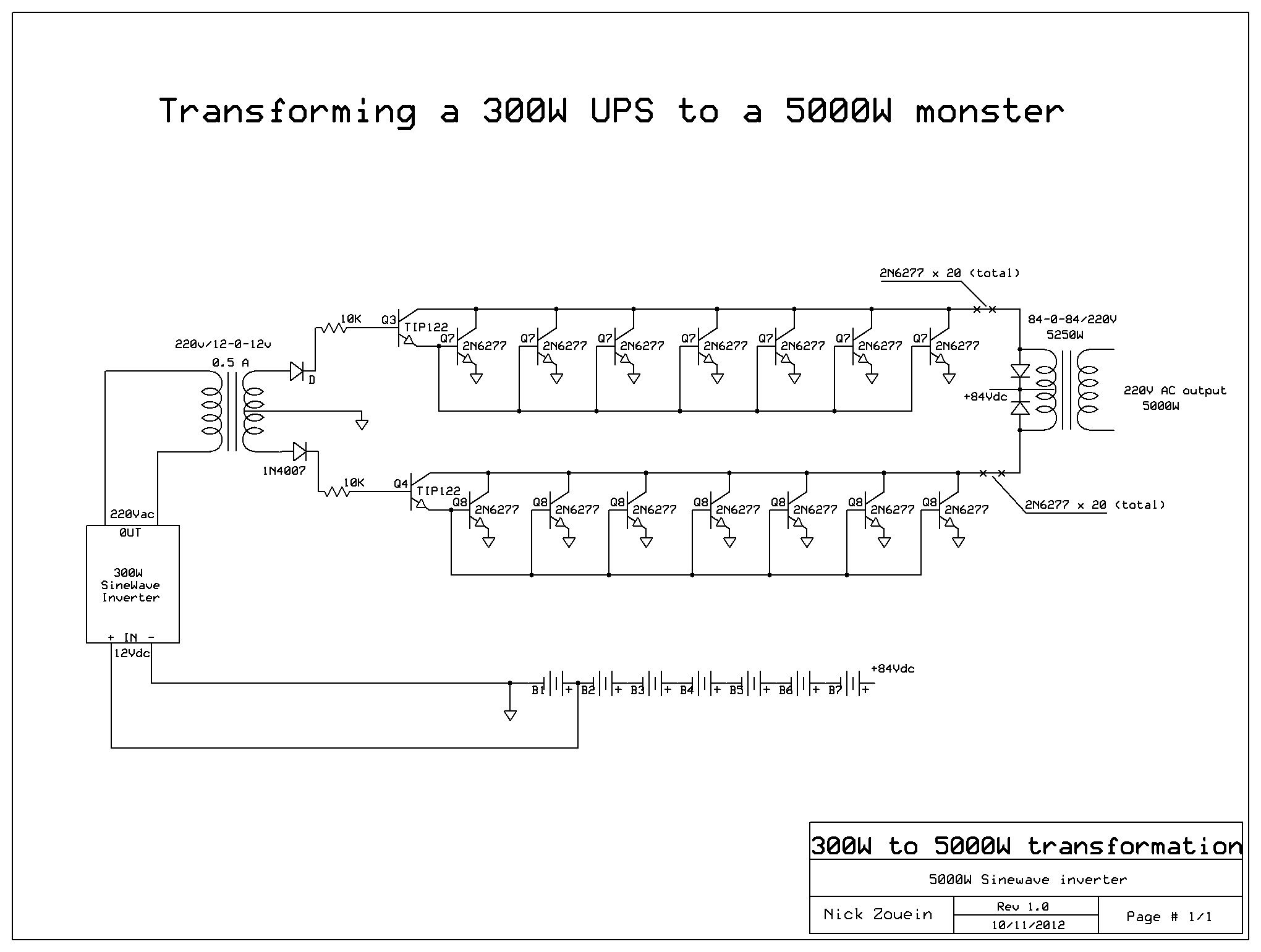

- You can build bigger versions of this inverter up to 5000w, to see what needs to be done on the power stage please see details on my other instructable here.
- Heat sinks are required to cool the power transistors they should be big enough to cool the transistors, they are separate and should NOT touch each other.
- Wiring connections marked in dark black on the power stage section should be thick enough to handle the big amps drain from the batteries.
- A cooling fan will be needed to reduce heat off the heat sinks and transformer.
