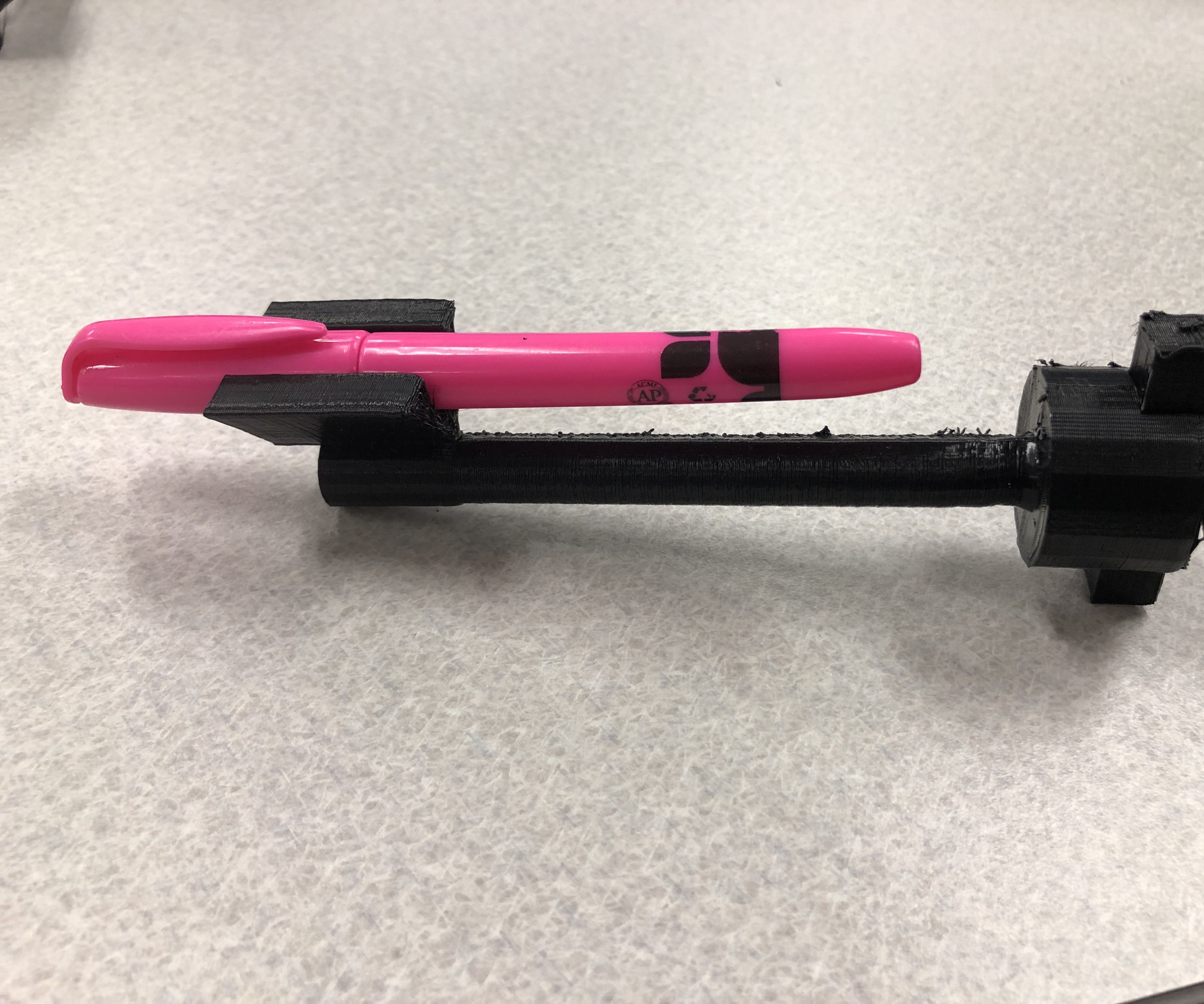

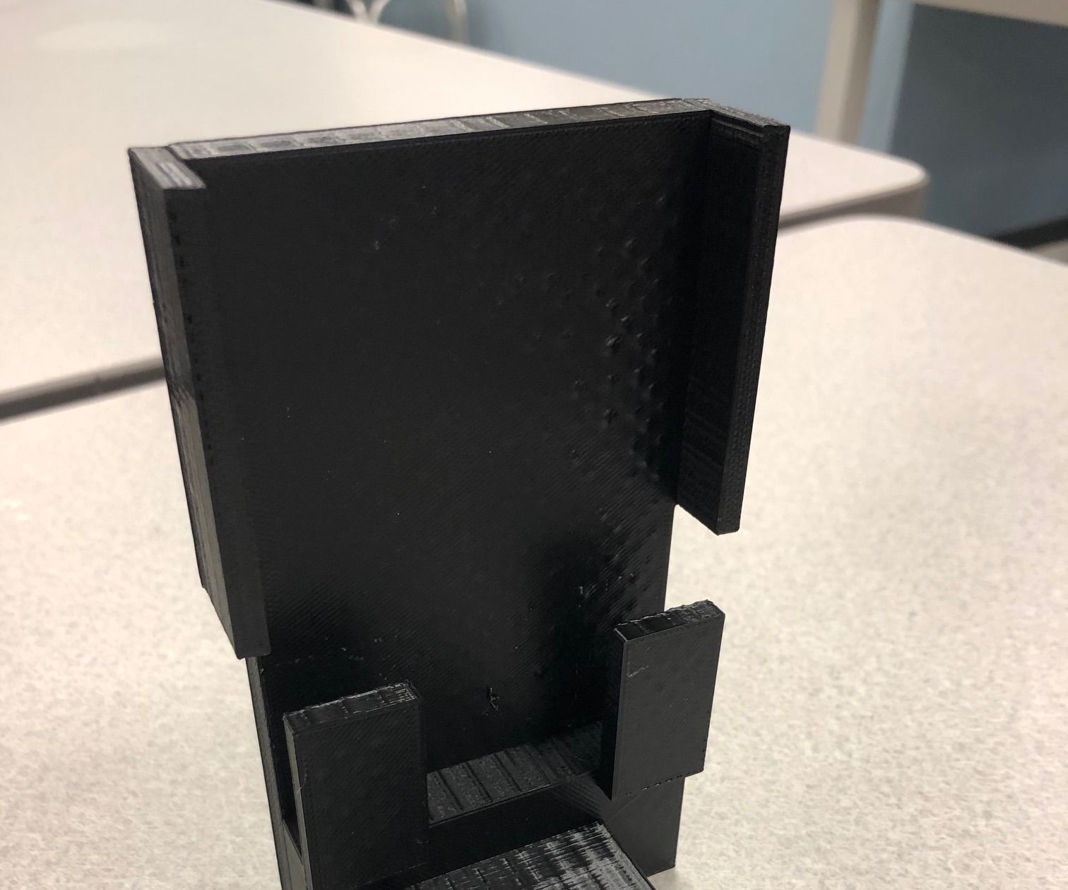

Step 6: Example of Attachment
On our page, we have adaption pieces. Here is an idea of what the end products look like together.
