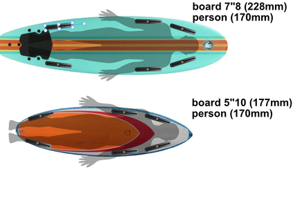

Step 1: Lay Out the Finboxes
Guidelines for Fin Box Placement
The surfer's body position while lying on the board is used as the main reference.
  1. Top fin boxes (handles): The centre of the fin box should be aligned with shoulder height and angled inward.
  2. Middle fin boxes (chest riser/handles): These should align with the torso area.
  3. Bottom fin boxes (leg guards): These should be positioned at calf height, near the rails. The leg guard should not come into contact with hard/bony areas such as the knees or feet.
  4. Fin placement: The fin box should be located at groin height, closer to the surfer's centre of gravity.
Tip:
After determining the desired positions, check the symmetry of the layout by measuring from the stringer as a central reference. Finally, mark the placement of each fin box with masking tape.
