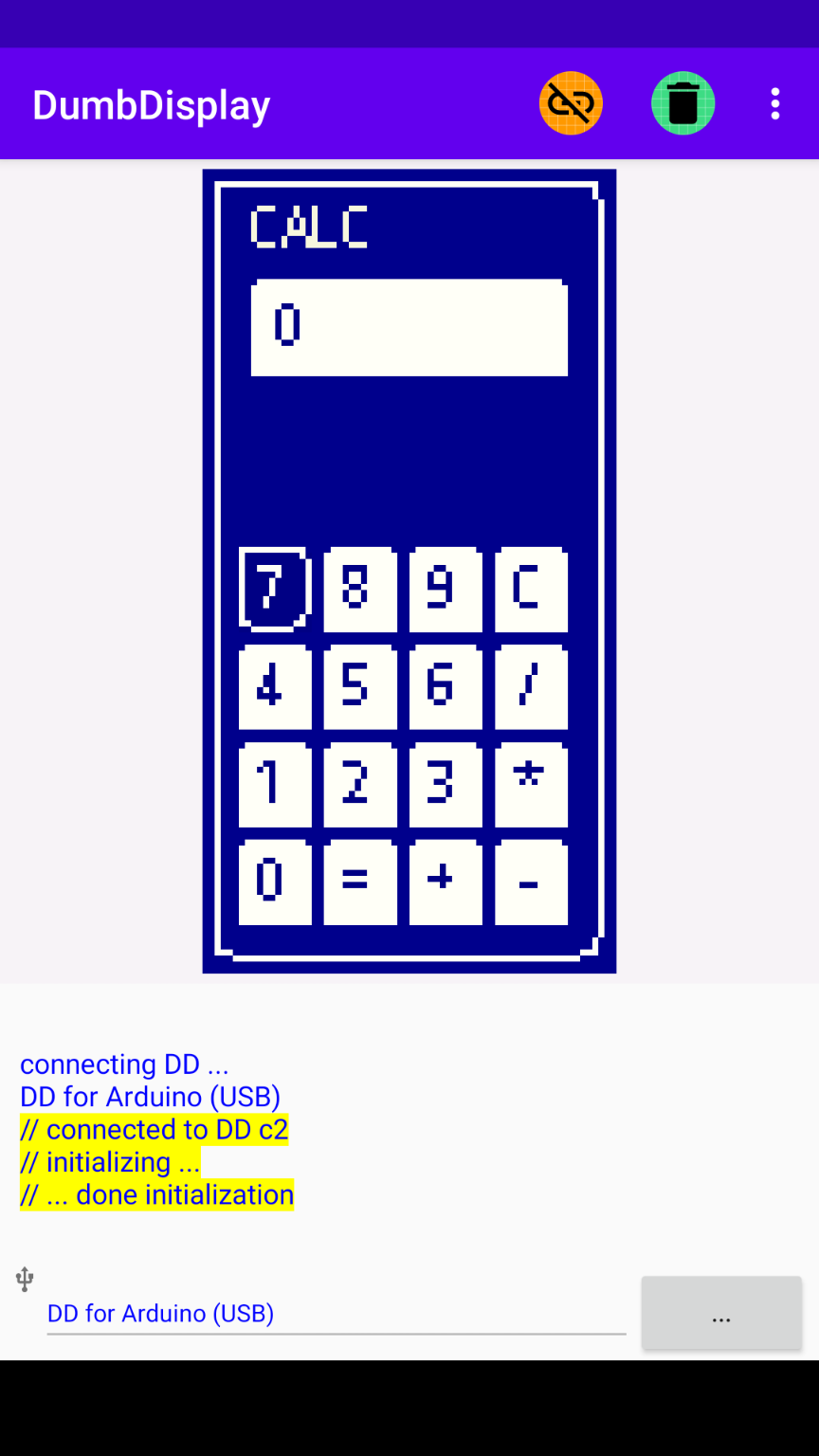

  • Caculator -- a, hopefully, working caculator

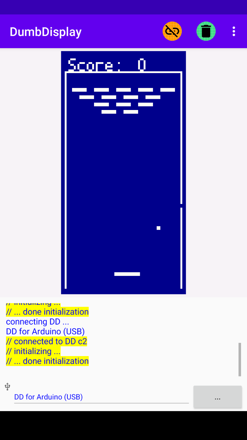

  • Game -- a simple "brick breaker" grame

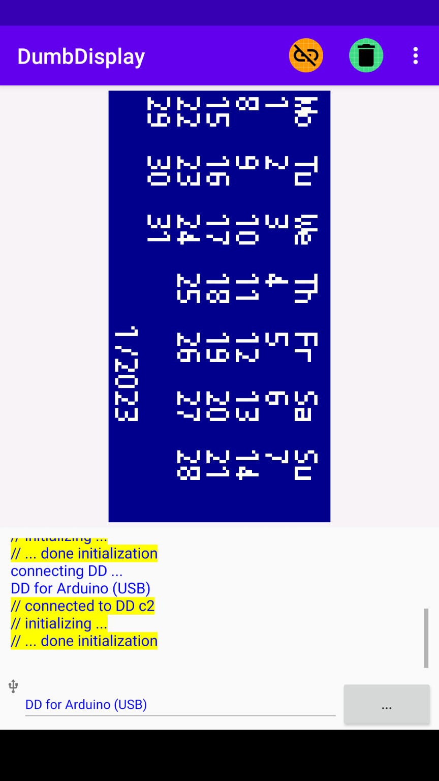

  • Calendar -- a simple calendar; just showing monthly calendar of select month

Step 7: Navigate the Caculator
The "left" button moves the key selection from left to right, top to bottom; similarily the "right" button moves the key selection as well, but in reverse direction.
If using the joystick, the key selection move more natually, in all four directions.
To select a key, press the "select" button.

Step 9: Navigate the Game
The game is a simplie implicatiion of the very simple form of the popular "brick breaker" game.
You use the "left" / "right" buttons to move the bar. You can also use the joystick to move to bar directly to a position, horizontally.
Since the joystick is not very accurate, don't expect too much. Nevertheless, I myself find using the "left" and "right" buttons to move the bar, makes the game fairly playable.

Pressing the "left" / "right" button will move forward / backward a month.
