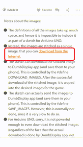

Notes about the images:
  • The definitions of all the images take up much space, and hence it is impossible to include it as part of a sketch for Arduino UNO.
  • Instead, the images are stitched as a single image, that you can download from the Internet.
  • The sketch can download the stitcked image to DumbDisplay app (and save them to your phone). This is controlled by the #define DOWNLOAD_IMAGES. After the successful download of the stitched image, it is croped into the desired images for the game.
  • The sketch can actually send the images to DumbDisplay app (and save them in your phone). This is controlled by the #define SAVE_IMAGES. However, this is normally not done, since it is very slow to do so.
  • For Arduino UNO, sorry, it is not powerful enough to even download the stitched images (regardless of the fact that the actual download is done by DumbDisplay app, not Arduino UNO). Hence, Arduino UNO relies on that the stitched image already downloaded to your phone somehow (see below).

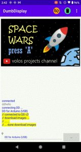

After uploading the sketch, re-plug the USB cable to your phone via an OTG adapter. Then, open the DumbDisplay Android app on your phone, and make connection.
Step 6: Enjoy!

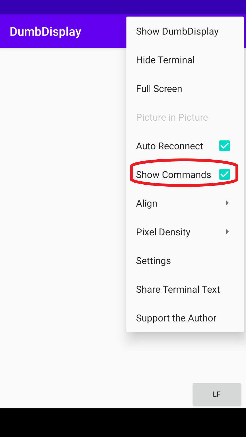

Two more things.
  1. You will need to grant permission for DumbDisplay Android app to access storage for the images.
  2.  It is suggested to turn off "Show Commands" of DumbDisplay Android app.

Here is a way to save image (the stitched image) to DumbDisplay app.
  • Use your phone's Chrome browser to open the image page
  • Long press the image to bring up the available options
  • Select to share the image with DumbDisplay app
  • Enter the correct name of the image, spacewarsimgs; note that you don't need to give it an extension, since image will be saved as PNG.
