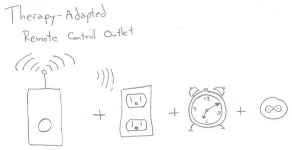

Introduction: Adapted Remote Controlled Outlet
I help out a local hospital by adapting toys and devices for children in speech, physical, and occupational therapy. One kid loved the sound of a box fan- however the AC part of adapting scared me off a bit both for kid safety and for liability reasons.
My workaround was to adapt the 12 volt DC remote instead. That's when my learning curve got steeper-
Requirements
1. a timer that controls an on switch and an off switch since the switch on the remote is designed to keep things on or off. (Decided on Arduino Nano)
2. a electrically safe means of controlling 12v supply with 5v signal. (Morphed from transistor to optocouplers)
3. plus a request from the therapist to make it adjustable for how long the device would remain on before shutting off.

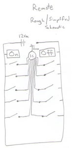

Step 1: The Circuit
This particular remote had a common 12V source and appeared to be switching things on the ground side of the switch. I'd originally wanted to use some 3904 NPN transistors (first time) but was thwarted when the common ground between the Arduino and the remote led to false signals.
This led me to try some optocouplers.
Optocouplers:
I love these little guys! I used two 4N35 optocouplers to create two separate circuits. (Arduino & Remote). Since they are electrically separate I could switch the two remote buttons individually using a pair of them.
*Note - If you haven't used them before- half of the optocoupler is an LED hidden inside there. DON"T FORGET YOUR RESISTOR! (Sorry to shout- I burned one of mine out in about .5 seconds!!!)
Resistors and Potentiometers:
There are 3 resistors in there- two to protect the optocoupler and one 1 Mega-ohm resistor in there as a pull-down resistor. (Pull-down resistors leech away the trickle of power that each pin might get to make sure your signals are definitely ON or OFF. Without it- things were acting rather finicky! -I'm hoping I didn't mix that up!)
The potentiometer (variable resistor or "trim pot") became my analog input whose resistance determined the delay in milliseconds between the ON signal and the OFF.

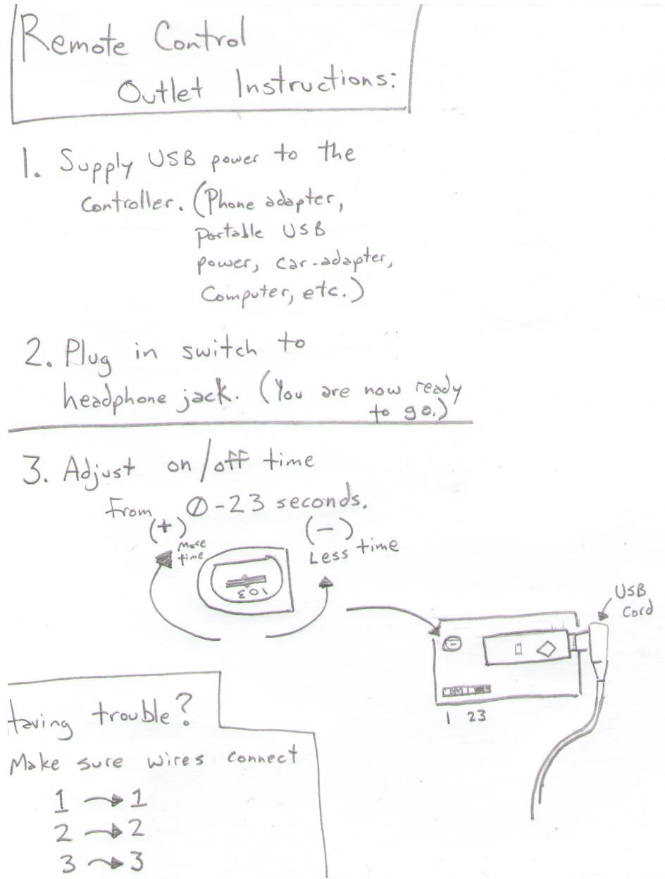

Step 3: Final Thoughts and Instructions for End-User
After a couple weeks of late nights I'm super excited to have it working. There are some quick instructions above for sharing if you want.
My next plans are to see if I can:
1. fit it more elegantly on a protoboard
2. add a potentiometer instead of a trim-pot. (No screwdriver required.)
3. more robust packaging
4. other changes based on feedback from therapist and families.
