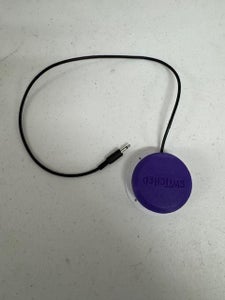

Many children with mobility disorders struggle playing with their traditional baby toys, however not many understand how easy and affordable it is to modify existing toys to work with 3D printed buttons, which makes kids able to play with them and impact their surroundings. Please note that this speaker will only function when the connected button is depressed. The button does not pause the music, it only restricts the speaker’s ability to play music. You can find the instructions for the buttons HERE.

Well done! You have successfully modified a toy to be activated with a button! To use, simply hold down the power button on the speaker until a blue light turns on. Then pair it via Bluetooth (following the directions that came with the speaker) and play some music through it. If you did it correctly, nothing should happen yet. This is expected. Simply plug in the button to the AUX jack, and press it down. Music should start playing through the speaker now. The button does not pause the music, it simply restricts the speaker's ability to play music. The speaker only works when the button is depressed.
