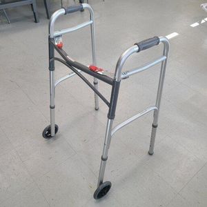

This step is simply putting together anything that needs to be put together. For us, the blue walker needed to be built.

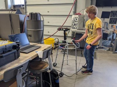

Step 2: Dimension Measurements
We used a caliper (as shown in the pictures) to measure the dimensions of the walker. After getting the dimensions, we sketched it out on paper to understand it better.

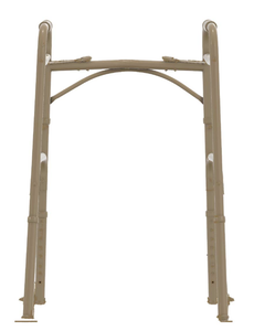

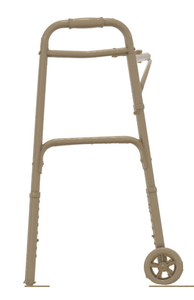

Step 3: Scanning the Walker
In this step we 3D scanned the walker so that we could have a 3D model to work with. We started by using a "Peel 3 3D scanner". This was fairly difficult to get a good 3D scan due to the shape of the walker. Eventually we used a Hexagon Absolute Arm to scan it which gave us a better 3D model.
There are also smartphone apps that can 3D scan objects, if you do not have access to the equipment in a lab.
