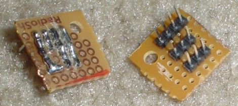

Step 3: Make a Power Distribution Board
Now you need to send power to the servo and Sharp IR. The best way to do this is to make a power bus - something that connects all grounds together, all power together, and a pin for each signal wire. The servo and the Sharp IR each have one signal wire.
To make a power bus, I got a piece of PC breadboard and male headers as shown. Then I used a dremel to cut off a small square peice of it, and soldered on the broken down headers with the proper power distribution wiring.
What does that mean? Connect all the grounds (black) to each other, and connect all the power lines (red) to each other. Each signal line (yellow) gets its own serial cable wire.
Then I plugged in everything to the power bus as so. Refer to the pinout in the previous step to make sure where everything plugs in to.
