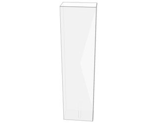

Step 5: Create the 3D Scissor Holder
To begin this, you will need to use a computer to access https://www.tinkercad.com. If you don't already have an account, you need to sign up for one (this is free). You then can use the various tools on the Tinkercad software program to design the scissor holder. There needs to be 2 rectangular shaped pieces that have a slit in them that will fit the metal ends of the scissors snuggly. This is when you will need to use the measurements you took using the caliper (the hole in each piece needs to be the size you measured). The overall width and size will depend on the size of your scissors and how wide your base is going to.
We attached the STL file if you want to download and 3D print our scissor holder!
Step 6: Print Out Your 3D Scissor Holder
When you have completed designed your 3D pieces online, you need to send them to a 3D printer to print out. The 3D printer should be monitored for the first few layers and may take a few hours to print out completely. It might take a few prints to get the sizes just right, so if it's not right the first time, you can tweak your design and print again. When you have your final pieces, simply push the 3D pieces on each end of the metal scissors.
