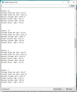

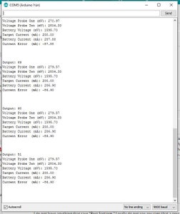

Step 4: Testing the Prototype
In order to understand the coding and validate if the coding works, the essential data has been sent to the serial monitor.
As can be seen on the serial monitor the battery charges when there is an output, when the battery is almost full the output lowers towards 0 and then the charger will stop charging the battery.
Before and after charging a battery, a multimeter has been used to validate the values.
