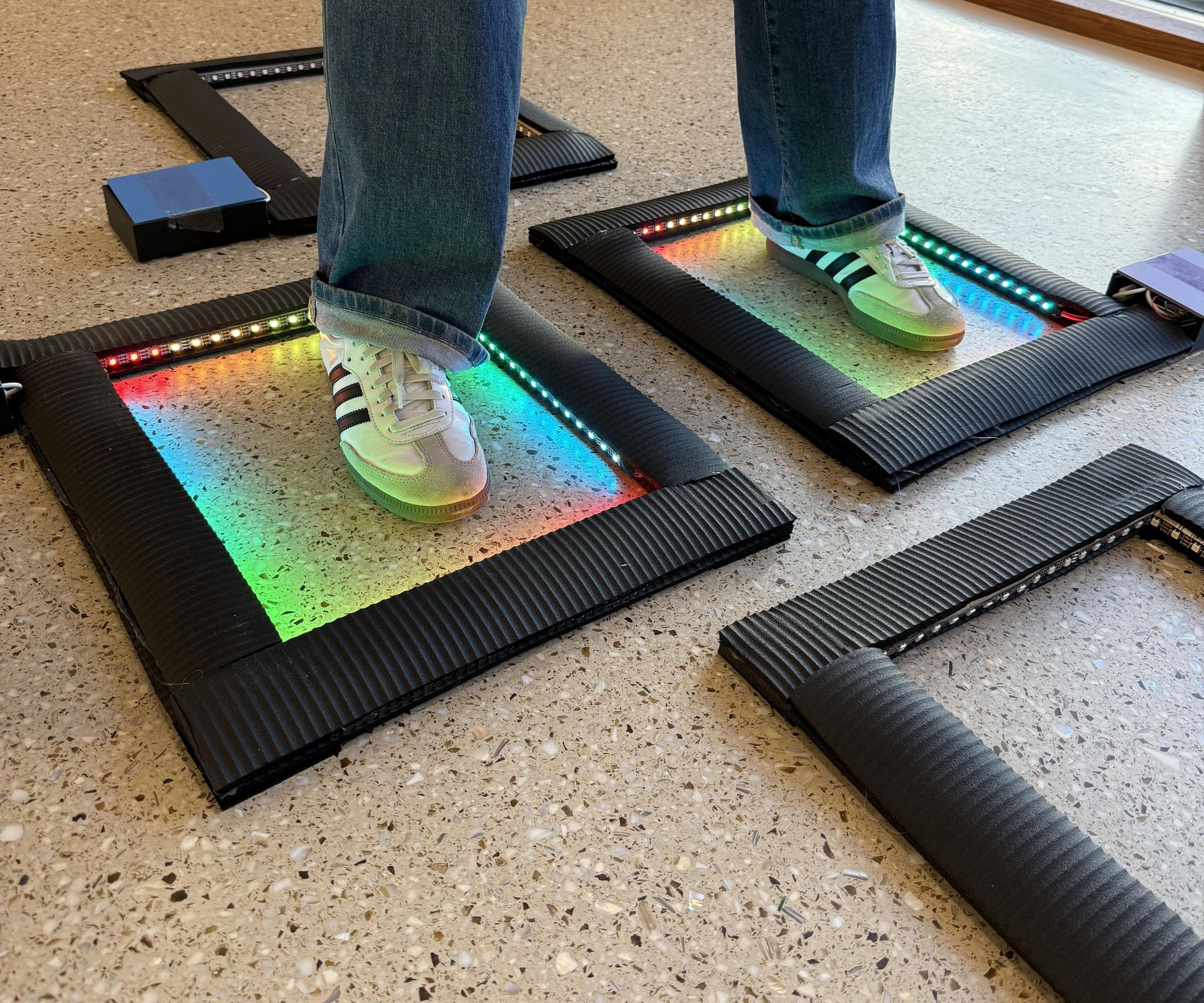

Introduction: Adaptive Tic Tac Toe
An adaptive Tic Tac Toe game that is displayed on two HUB75 Matrices. This project was created for the students at Boston College's Campus School. Powered by a Matrix Portal S3, 12 pad Capacitive Touchpads, and an plug in brick.

Step 4: Soldering Time
Carefully - Solder on end of the wire through the hole in your fabric square. Complete this for both squares.
Step 5: Feed the Wires
Feed the wire through the 3D printed parts as shown in the images.
Step 6: Soldering Time Part 2
Solder the other ends of your wires to the Capacitive Touchpads. If you are following our given code, solder one wire to the "0" touchpad and solder the other wire to the "6" touchpad. "0" will be the X player and "6" will be the O player.
