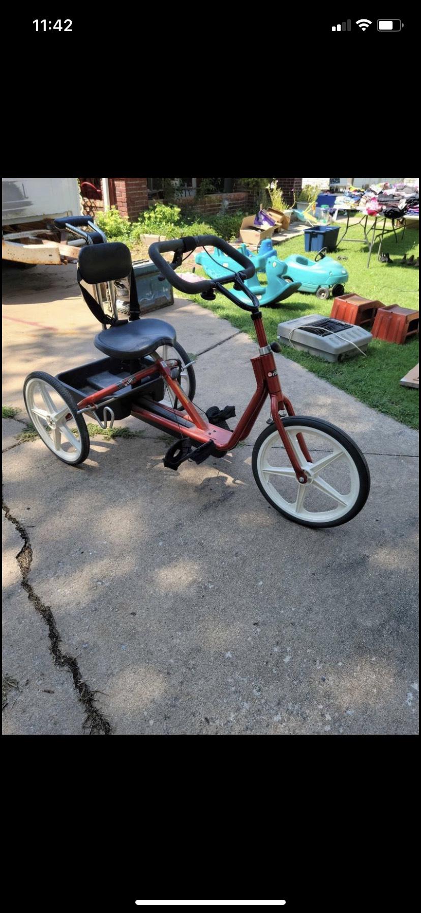

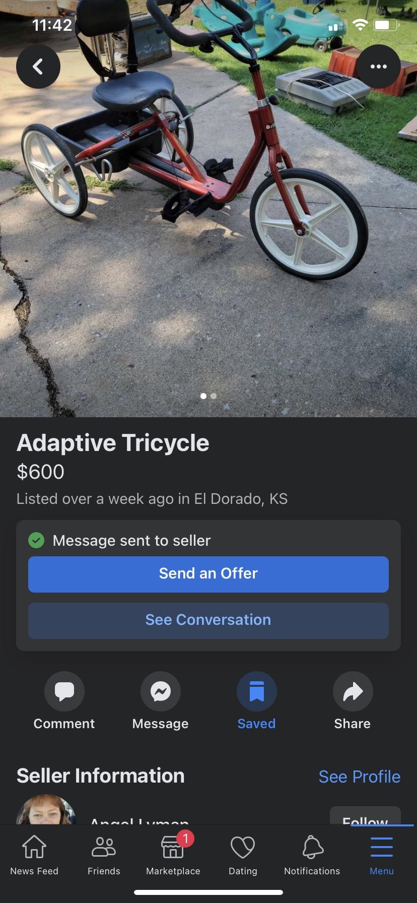

We also thought was that we needed to build a bicycle from scratch, but due to time constraints that was not a viable option. The team then met to come up with ideas as to where we could come up with a sufficient starting point to build from. After doing research over potential candidates for a tricycle, the team thought to look on the local Wichita Craigslist and Facebook Marketplace.
After some further searching using these websites, we discovered a perfect deal on a gently used tricycle. The model that we found was a Rifton R140, which just so happens to be one of the most expensive and top of the line assistive tricycles offered on the market today. The Rifton is made in the USA, and is a weld together model using aluminum tubing for the body and brackets. It also comes with a fully adjustable front brake handle, fully adjustable steering bars, fully adjustable seat, upper and lower seatbelt restraints, sturdy parking brake, and a convenient lower mounted storage basket. The model also offers a completely floating pedal system, which eliminates the user from overexertion when trying to pedal as it adds to their pedal motion to makes a smoother feel.
The tricycle itself was a great deal, at a mere fraction of its original MSRP, and this one in specific was very lightly used. After a nice deep clean on a Saturday afternoon, the tricycle was looking like new.
