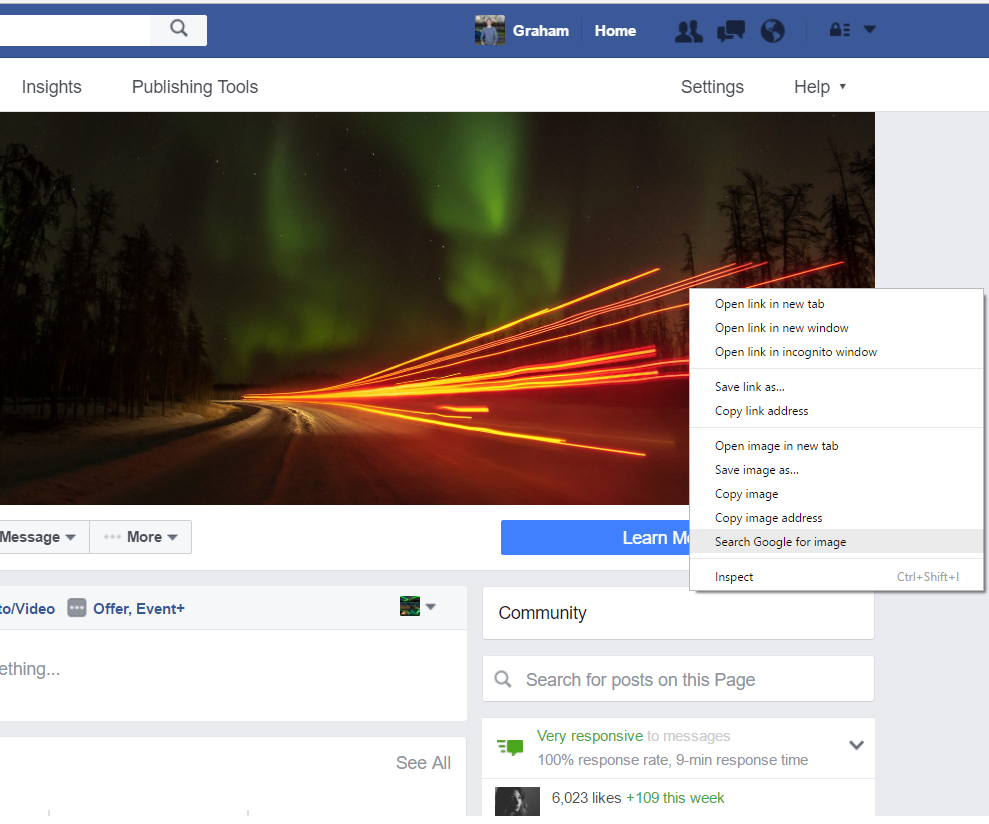

A google search of your vehicle should tell you what size of alternator you have but, If you have any questions or would like help figuring this out I am more than happy to help. Just post in the comments or drop me a message.
