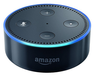

There are basically two things you need to do to voice enable your IoT device for use with an Echo or Echo Dot:
1 Create a Lambda Function
2 Setup a Custom Skill
The Lambda function is an Amazon Web Service (AWS) that allows you to write the function to handle the requests that come from Alexa. The Lambda function can be written in Node-js, Java or Python. It’s available to run 24/7 and is hosted on Amazon’s servers. In our situation it will handle the RESTful interface with the IoT device.
The Custom Skill consists of configuring the Actions you want to take (“Device Directives” in AWS speak), and the words you’ll say to Alexa to trigger those Actions (“Utterances” in AWS speak). It performs the task of triggering the Lambda function when you speak a phrase to your Echo Dot that matches a trigger phrase.
As an example consider a Lambda function called Hello World, whose function is to say “Hello World” whenever you trigger it. Your trigger phrase will be “Say Hi“, so you’ve also configured a Custom Skill to recognise that phrase. To trigger the Lambda Function you say: “Alexa, ask Hello World to Say Hi“. “Alexa” is the wake-word to tell the Echo Dot to listen, followed by the name of the Service/Function you’re asking it to trigger and finally the Trigger phrase. Once triggered like this, Alexa responds with the response programmed by the Lambda Function “Hello World”.
