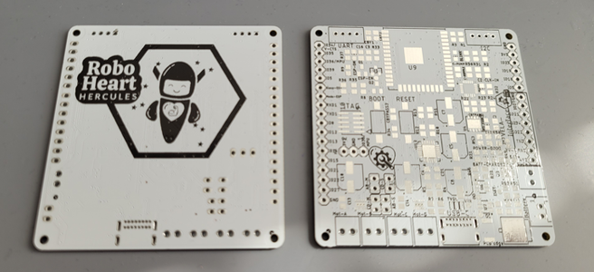

In this tutorial you will go through a step by step process to add an image to the silk screen layer in your Eagle layout.

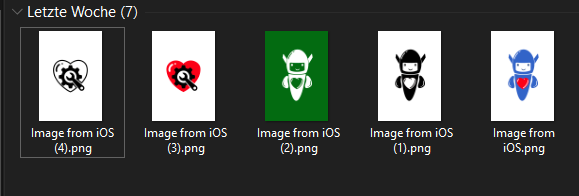

Step 2: Select an Image From Your PC
Keep in mind: only a monochrome print is possible.

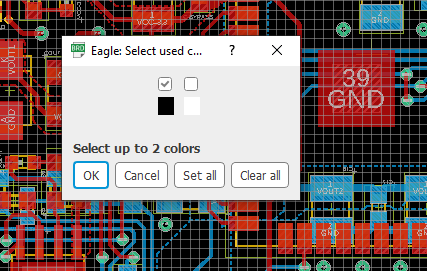

In the pop up window select “No Scan” and the color black, press OK.

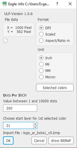

Select Format: DPI; Unit: Inch; and in the field “Dots Per INCH” you type your preferred size for the image on the PCB. The smaller your DPI-value the bigger your image on the PCB will be and vice versa.
Important: Select the layer where the image is going to be printed.
Recommended for Top side: 21
Recommended for Bottom side: 22
Click OK.

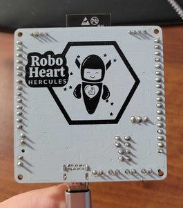

When you are satisfied with the logo size, you will find a very small caption (image path) at the bottom left corner of the imported image. Delete this caption.
