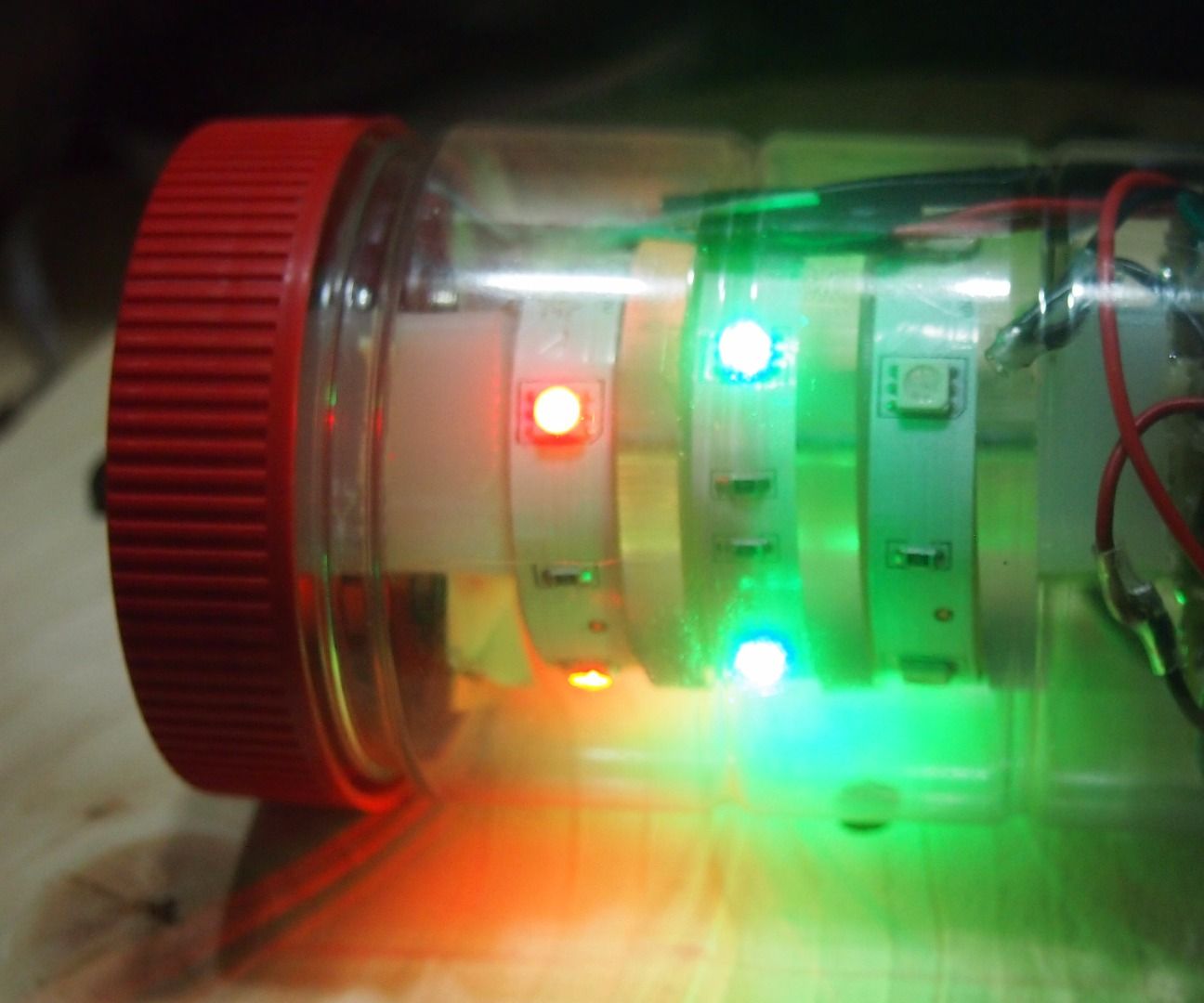

Introduction: Add Sound to Projects.
Making a Prop and need sound? This instructable shows you how to add sounds to any project the quick and easy way. We will show you the basics of how this sound board works.
