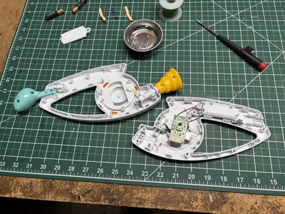

Step 1: Remove Screws and Carefully Take Bop It Apart
Remove the screws on the back of the Bop It and slowly pull it apart. Be careful not to lose any small pieces. There at least two plastic pieces that are easy to lose.

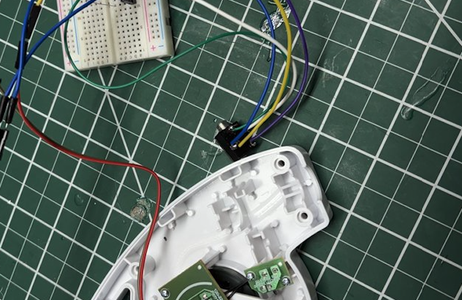

Step 3: Solder Wires to Switched Headphone Jack
Solder different colored wires to the five terminals on the headphone jack so they are easy to identify. Be careful not to accidentally short any of these connections.
Step 4: Wire According to Wiring Diagram
Refer to the wiring diagram above and splice the wires together accordingly. You will need 4x 330 Ohm resistors for this. If you don't have those, you can experiment with different resistors. The resistors lower the power going to the headphones to reduce transients and volume.

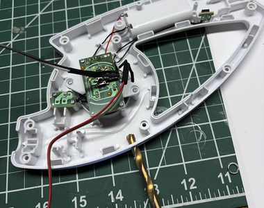

Step 5: Drill Hole for Headphone Jack
Drill a hole using a 15/64 drill bit for the headphone jack. I drilled mine in the bottom half of the case so I could still open the case if I needed to make any further modifications.

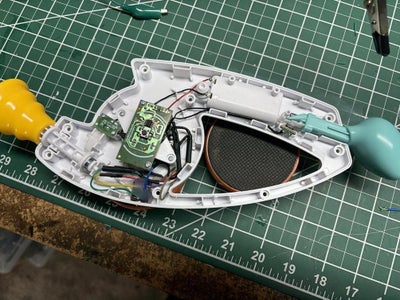

Step 6: Hot Glue Headphone Jack Into Place
Hot glue the headphone jack into place. Make sure to not get any hot glue on the edge of the case as that will prevent you from closing it back up at the end.

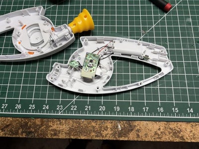

Step 7: Put the Two Halves Back Together
It can be tricky to put the two halves back together. Make sure the two small plastic pieces for the Twist It and Pull It mechanisms are in the correct position (you can reference the previous photo for this). Then snap the case back together and reattach the screws.
