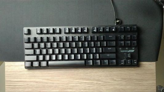

Step 1: Disassemble Keyboard
Since access to the keyboard PCB is needed, the first thing to do is to find all the screws that are holding the keyboard body. The screws could be located on top, bottom or both of the keyboard. It may also required to remove (several) key caps to have access to the screws.
This is an easy thing to do, be prepared for next steps.
Step 2: Locate the Wire and Cut
You need to locate the wire that connects to the PCB. Since this is USB cable, usually there are colored cables inside. Usually the colors are red, black, white and green. Do not cut the cables too short, make sure you leave quite a bit length, just in case. Strip the each of the colored cables and leave enough length to solder.

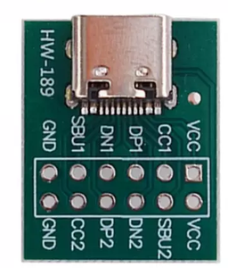

Step 3: Solder Cables to USB C Socket
Here is the fun part. Make sure you have basic soldering skill before proceeding with this step. Above are pictures of different USB C sockets. Those are what I recommend to use. The main consideration of choosing such USB C socket is the size, make sure it is small enough to be placed inside the keyboard. Make sure to find the best location inside the keyboard to glue the USB C socket.
Like I mention before the cables should be colored. Here is how to connect the right cable to the right port.
  • Red cable to VCC
  • Green cable to D+ (data positive)
  • White cable to D- (data negative)
  • Black cable to GND
The USB C socket that I bought has 12 ports / holes. Please refer to the diagram above on how to wire to this kind of socket. Use (black) electrical tape in order to insulate and secure the cables.
